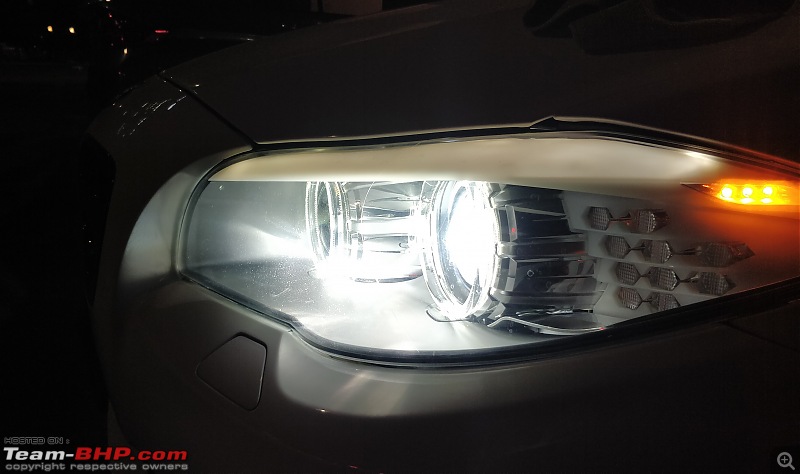

EGR Hard Delete + New bulbs
As I had mentioned earlier the stock OEM HID bulbs seemed to have become dull, and the output was very pedestrian. I had a friend carry down these replacement bulbs from the U.S.
My pre-owned BMW 530d (F10) Edit: Sold!-img20190512wa0014.jpg
BMW's manual says you cannot replace the HID bulb as they are a "lifetime" bulb, and you should goto the service centre for any issue. However the replacement was quite simple. Turn the wheel fully out, remove the cover held in by two philips head screws, turn the dust cap out, disconnect the connector, turn and carefully remove the bulb, put the plastic fitment in the same angle as the old bulb onto the new one, and do everything in reverse. Ensure your car is locked and that no power is flowing to any bulb.
New bulb on driver's side, old one on passenger's side. Can see the difference in brightness.
My pre-owned BMW 530d (F10) Edit: Sold!-img_20190523_221117.jpg
Nice OEM colour
My pre-owned BMW 530d (F10) Edit: Sold!-img_20190523_222252.jpg
Long low beam throw
My pre-owned BMW 530d (F10) Edit: Sold!-img_20190524_213443.jpg
High beam is good too
My pre-owned BMW 530d (F10) Edit: Sold!-img_20190524_213440.jpg
