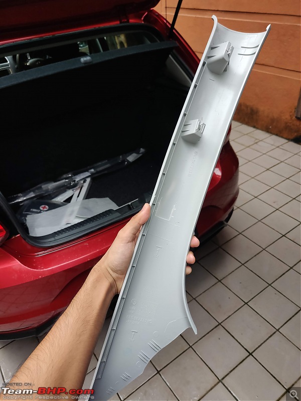

Review: Driving home our Sunset Red VW Polo Highline+ TSI Automatic-apillar-without-foam.jpg
On removing the A-pillars, I noticed how the A-pillars now had only two clips and plastic holders as opposed to three in the past.
Review: Driving home our Sunset Red VW Polo Highline+ TSI Automatic-pillar-foam.jpg
Review: Driving home our Sunset Red VW Polo Highline+ TSI Automatic-apillar-foam.jpg
Previous cars would also get an insulation inside these A-pillars and I managed to procure these two grey foam inserts for insulation from a scrap car. Volkswagen just doesn’t fail to amuse when it comes to its cost cutting skills.

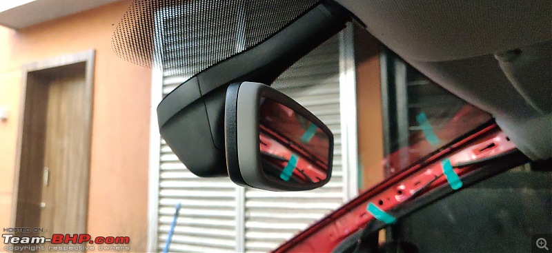

The Highline variant of the PQ25 Polo and Polo Sedan were fortunate to come with an Auto-Dimming IRVM and this has been one of my favourite features in this car. It's sleek and works like a charm. No hassles of flipping the Day-Night IRVM toggle like I have to on our Grand i10.
Review: Driving home our Sunset Red VW Polo Highline+ TSI Automatic-stock-irvm-click.jpg
However, I was fascinated by the frameless IRVM from the Passat and Tiguan which is even more sleeker and so I found a used one in excellent condition on Ebay UK for 40 GBP and ordered it. Taking out the old mirror is fairly simple and needed just a trim removal tool. It also helps to have some micro-fibre cloths ready since I ended up greasing the windshield with my oily fingers.
Review: Driving home our Sunset Red VW Polo Highline+ TSI Automatic-stock-irvm-autodimming.jpg
The plastic shroud on the windshield is neat and houses the mount for the Rain and Light Sensor. The upper neck like trim houses the wiring for the same. The bottom fat trim needs to be slightly pried and then it frees downwards along the windshield. Here's a look at the two plastic locks it has on each side.
Review: Driving home our Sunset Red VW Polo Highline+ TSI Automatic-irvm-bottom-trim-removed.jpg
After the bottom-most bulkiest trim is out, we can take the upper longer tube out.
Now, there's a metallic clamp, which turns and clasps onto the Rain and Light Sensor fitted to the windshield. Hold the aluminium part of the Stock Auto-Dimming IRVM firmly and rotate it to free the claws from the Rain and Light Sensor.
Review: Driving home our Sunset Red VW Polo Highline+ TSI Automatic-rls-wiring-view.jpg
With respect to the picture, turning left helped me unscrew the mirror claws from the notches and get it out of the way. Take the connector out and install the new mirror in reverse order. Upon fitment, the mirror should be nice and tight and vibration free, just like it was before.
