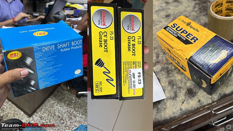

Sometime in September, @vigsom had visited chennai and while he was inspecting my car when we met, he noticed a dampness in one of the driveshaft boots. I kept using the car very minimally and had to push the repair by a month due to travel and work.
We tried to figure the right model of boot through Boodmo but since we couldn’t get a clear view of the boot through the wheel well, it was difficult to finalise. To clear this confusion, i took the car to Lanson Toyota on 11th Oct and requested them to get this inspected. They were kind enough to inspect it and also to let me take photographs of the underbody. But they were persuading me to change both the driveshafts - as expected from an A.S.S. The issue here was with the Passenger side - Gearbox side boot - which was leaking grease. The driver side - Gearbox side boot was mildly damp.
I went searching for the boot as Toyota doesn’t sell the child part. Finally, Mahavir automobiles confirmed they have the right one and purchased one piece (i wanted to change both but they had just one) for 750 rupees. On the 25th Oct, I took the car to my mechanic, Senthil, who lives pretty far from Chennai. To my shock, when he removed the driveshaft and compared the boots, the one that was given to me were a size bigger and will not fit! Imagine this - my car is on a jack, 25 - 30 kilometers away from home in a road that’s super narrow even for a car - and with me having an international trip next morning.
We then had a joy-ride on his bike - hunting for the boot in many spare parts stores that he knew. He told me that if not the corolla boot, Indigo CR4’s boot might be a match. After a couple of hours of bike ride in scorching heat, we finally found one piece of a boot of a CR4 that was very very similar to the Altis one, albeit very slightly larger in diameter. We got back to the car and he was able to fit it comfortably. If I had got another piece of the boot, I would have asked him to change the other one as well but luck didn’t favour me that day.
Total cost - Rs. 300 for Indigo CR4 boot and 1000 rupees labour.
Items purchased from Mahavir
Pre-Worshipped Toyota Corolla Altis VL-AT (E140) - 71k kms Update | Now Sold-purchased-items.jpeg

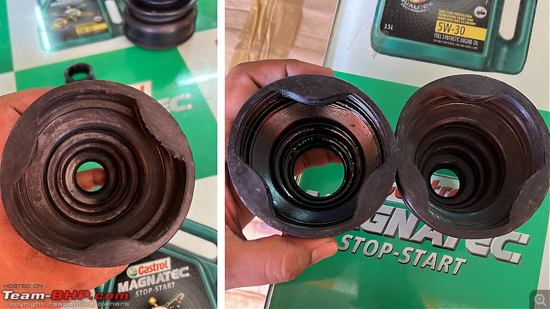

Left is the torn boot and right is the RGB boot. Notice the difference in size and projections
Pre-Worshipped Toyota Corolla Altis VL-AT (E140) - 71k kms Update | Now Sold-altis-vs-rgb.png
Close similarity between CR4(left) vs Altis boot.
Pre-Worshipped Toyota Corolla Altis VL-AT (E140) - 71k kms Update | Now Sold-cr4-vs-altis.png
