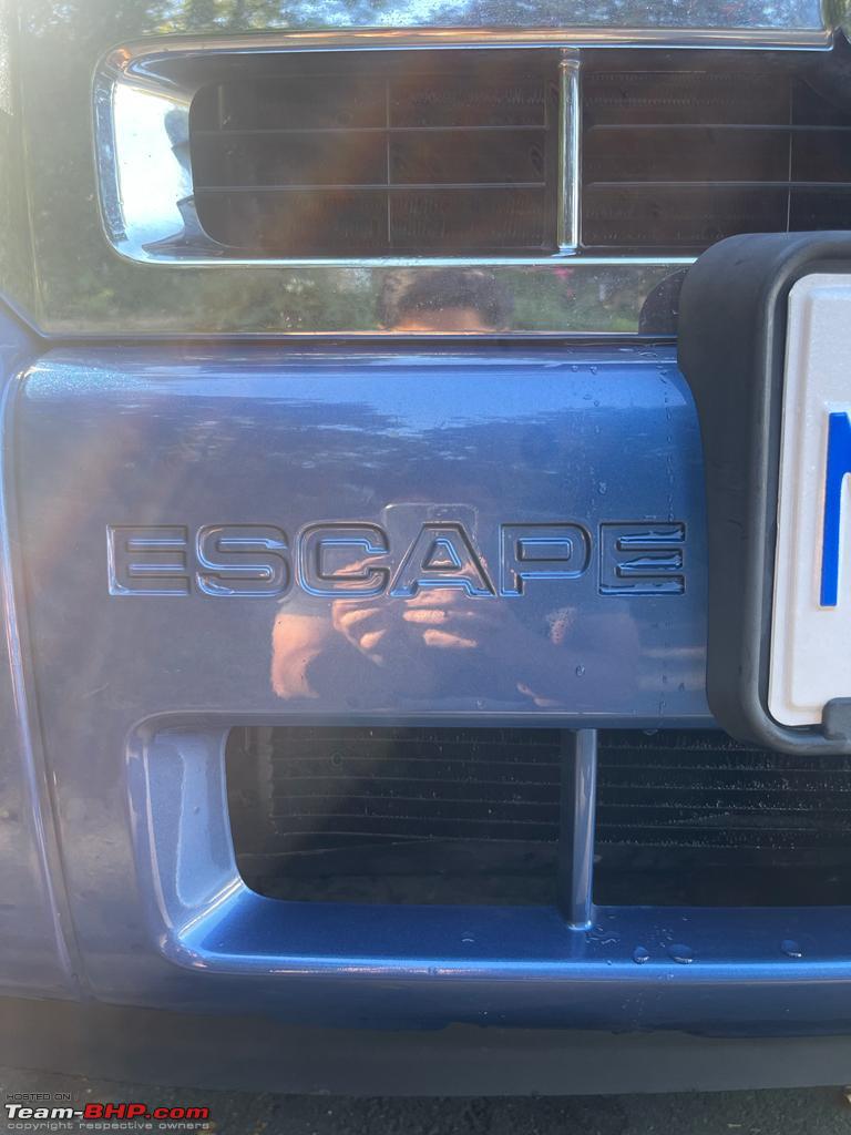

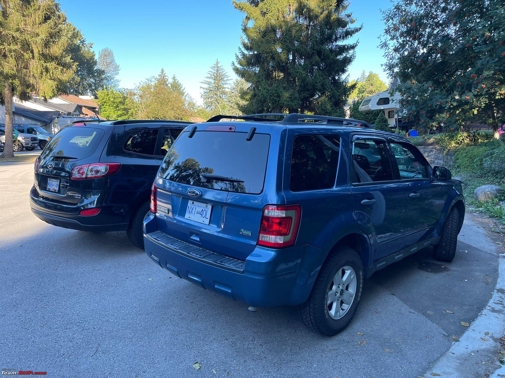

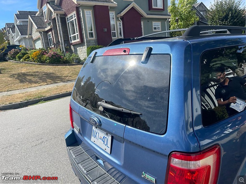

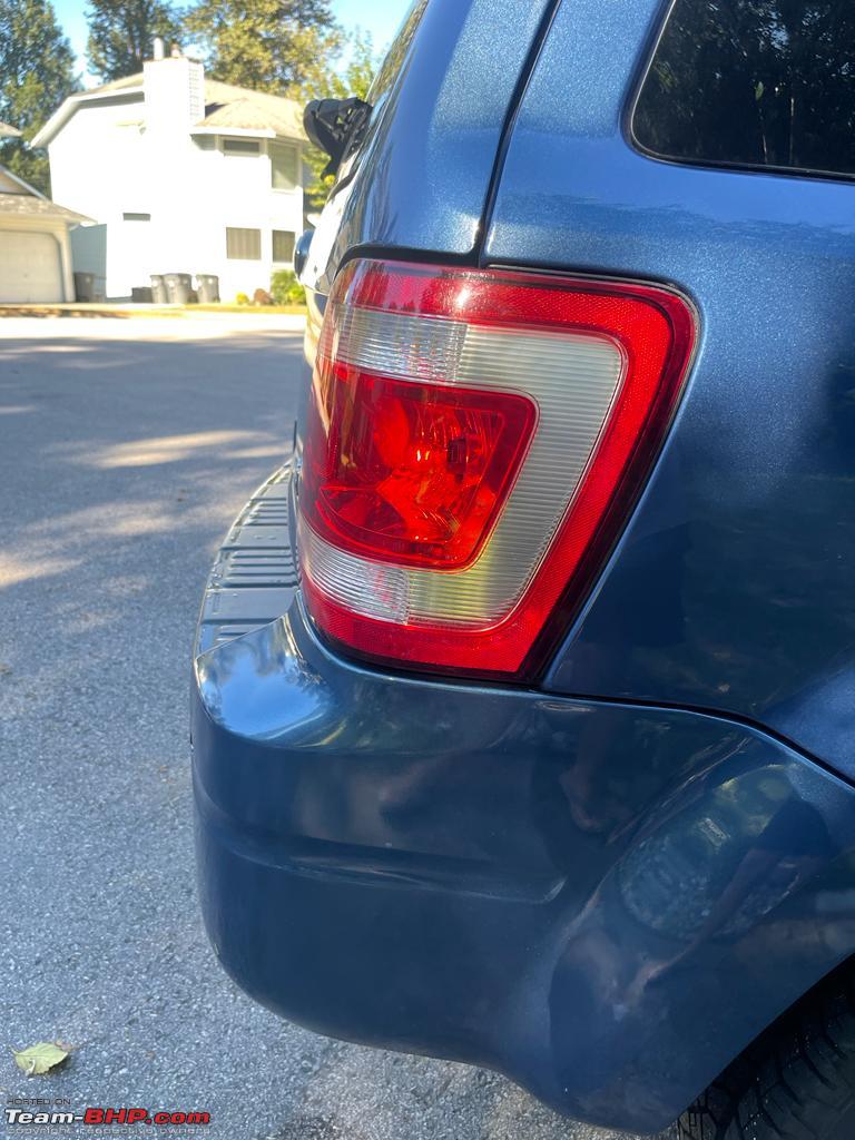

This car looks just so beautiful. Those rugged tires, the square shape everywhere, it all looks great in flesh and in pictures. I am loving this color even more with each passing day. You look from any side and its all squares and lines, I like it but that might be not to everyone's taste. I love how the ESCAPE is embedded in front bumper. Glad that the chrome isn't there. The Tail lights are tastefully done and this car looks great from every angle. There have been reviews on the internet stating that this car isn't a looker but I disagree, you look at it every time when you park it.

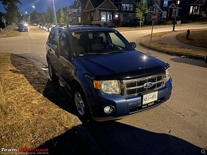

The front

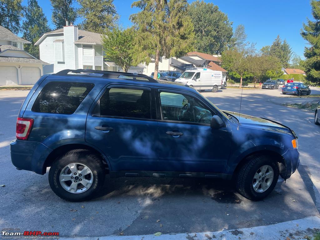

The Side Profile

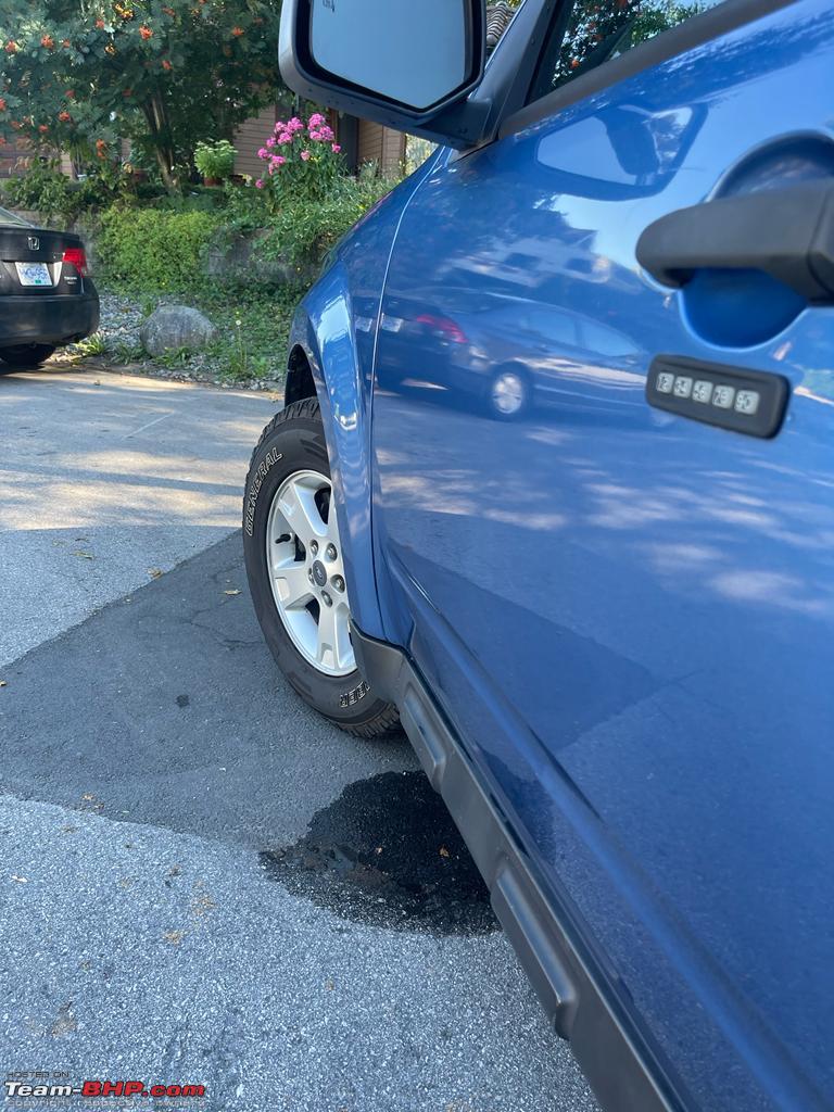

Still have to figure out this lock on the door.

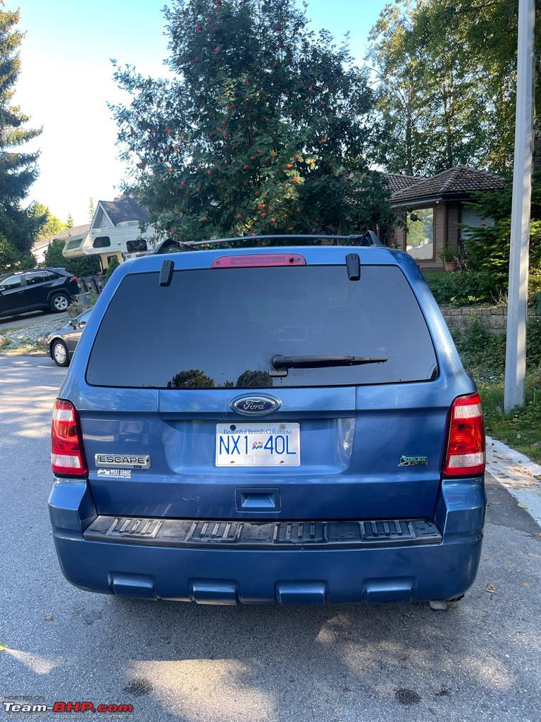

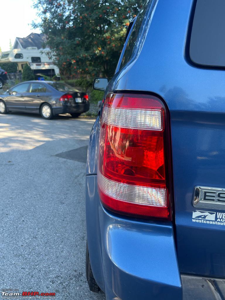

From the rear angle

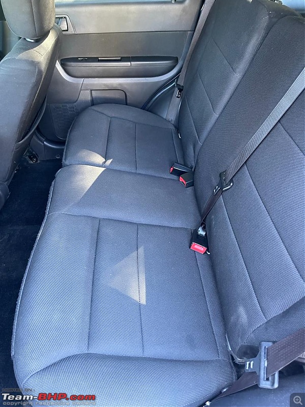

The Interior:
The Escape comes in the black or beige interiors. Again, its the same story once you step in, its all square everywhere. The fonts on the driver's console are clear and big. Everything feels practical, its a lot of plastic but gives you the build to last feeling. The central console has a lot of buttons and that is really distracting for a new driver of this car, it takes a little bit of time to learn where the buttons are, like now when I drive I still need to figure out but A's fingers go to right spot without him taking his eyes off the road. There is no heated seats but there is Bluetooth functionality but me and A haven't still figured it out.
The middle row seats fall down all the way and gives you enough room to haul as much as you wish. The seat cushioning everywhere is good and you don't feel tired on longer journeys. We are not tall people, I feel even though Escape looks big and almost the size of my Santa Fe (more on the comparison below) but Ford could have managed space in a much better way. My biggest complaint is how the lower dashboard is made, the angle of the plastic and positioning is such that your knees will be touching the dashboard if you're tall, mine were touching once the front seat slides forwards. So, there would be some adjustments if there were taller people or they won't be comfortable at all. Now, don't think that taller people don't own the Escape but what I think is that they are travelling only in a group of 2-3 people maybe and then can sit comfortably in the car. Also, the material used all around the seats is a dirt magnet, so it will needs good upkeep. There is support of putting in child's seat so that is a good thing.
The cupholders are there but they are not that big and aren't able to hold regular size bottles but will do just fine with coffee cups etc. The AC is a chiller in this one, there are no vents in the middle row but till now we haven't used it to the max setting and had to turn it off in between because even the lowest setting starts chilling you to the bone. The sound system is a CD Changer and is of good quality. We all loved it.
One of the best feature of the Escape is the opening of only Glass Area at the rear and it is so convenient when you're in a hurry and just need to keep small things in the cargo area.
Attaching interior pics below:

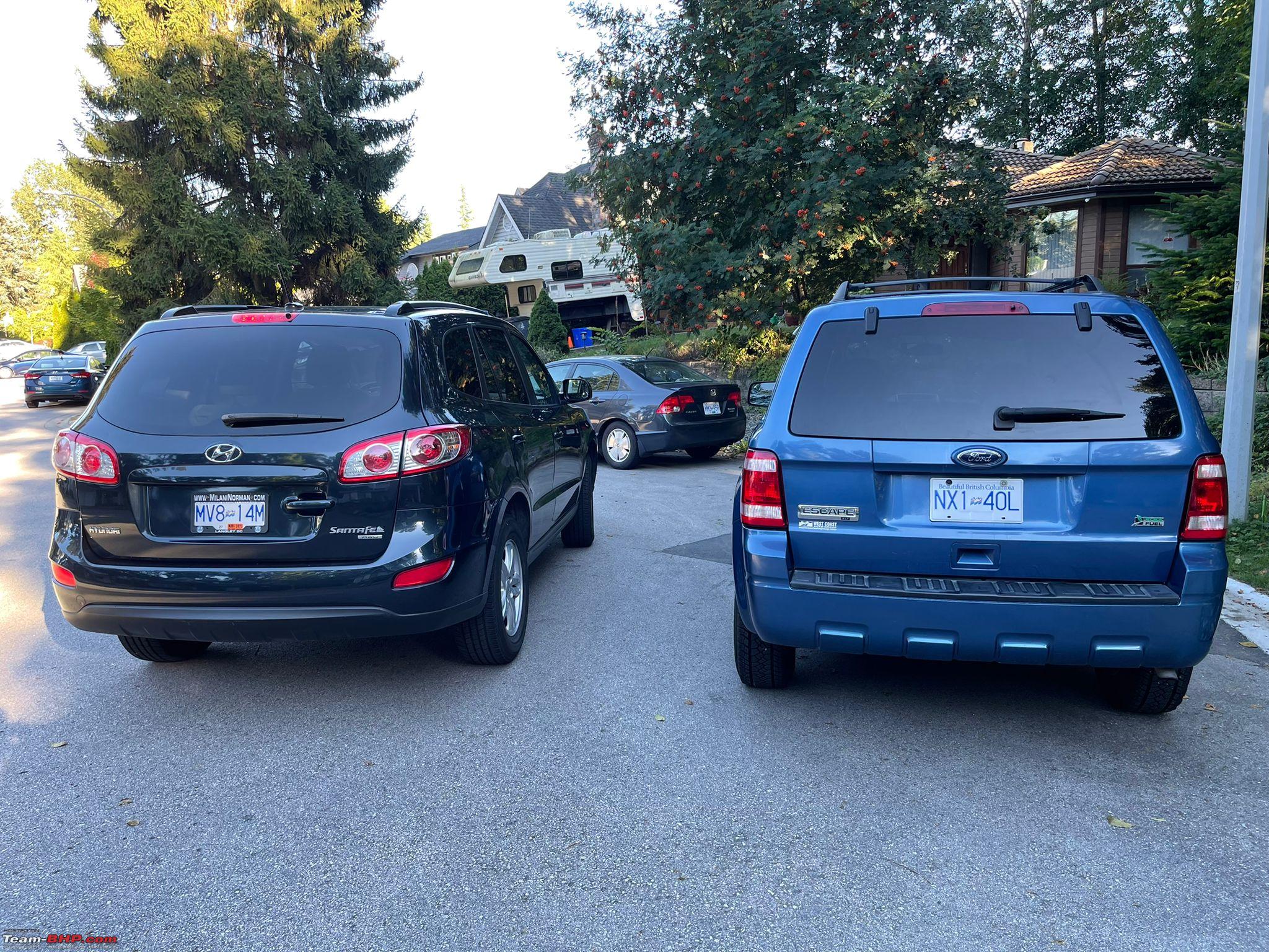

Comparing to the Hyundai Santa Fe
Why the Santa Fe you ask because like I mentioned earlier it is one of the cars which are in the same budget cap. Also, I own it and A drove it quite enough before he bought his own car so naturally the comparison was going to be done. Let's get started on it then:
  • The Santa Fe and Escape look almost same in size and from some angles it feels that Escape is towering over the Santa Fe.
  • Power delivery in Escape is linear while in Santa Fe it is relentless. You have to be careful how you press the accelerator in the Santa Fe but Escape is so so better especially in the city.
  • Excellent visibility in both the cars but you get more sporty feeling while driving the Escape.
  • Space management is way better in Santa Fe compared to Escape. Even with the child's seat in the middle row, two adults can easily sit in the Santa Fe which is definitely doable but not comfortable in Escape.
  • There is no glass opening provision in Santa Fe
  • Escape is more fuel efficient.
  • On the highway, Escape feels a little bit slow when accelerating but it will get you there!
  • Santa Fe has all four disc brakes which is great from Safety perspective and also more airbags.
  • There is no Differential lock in the Escape which is given in Santa Fe
  • Escape gives you more feeling of a Guy's car while Santa Fe is for family person.
  • Santa Fe is a little bit more expensive in the used market when compared to Escape.
There might be more points to add to the list but these are the one's which I can think of as of now. I will add more points as the time passes by with both the cars. Attaching pics of both the cars together.
