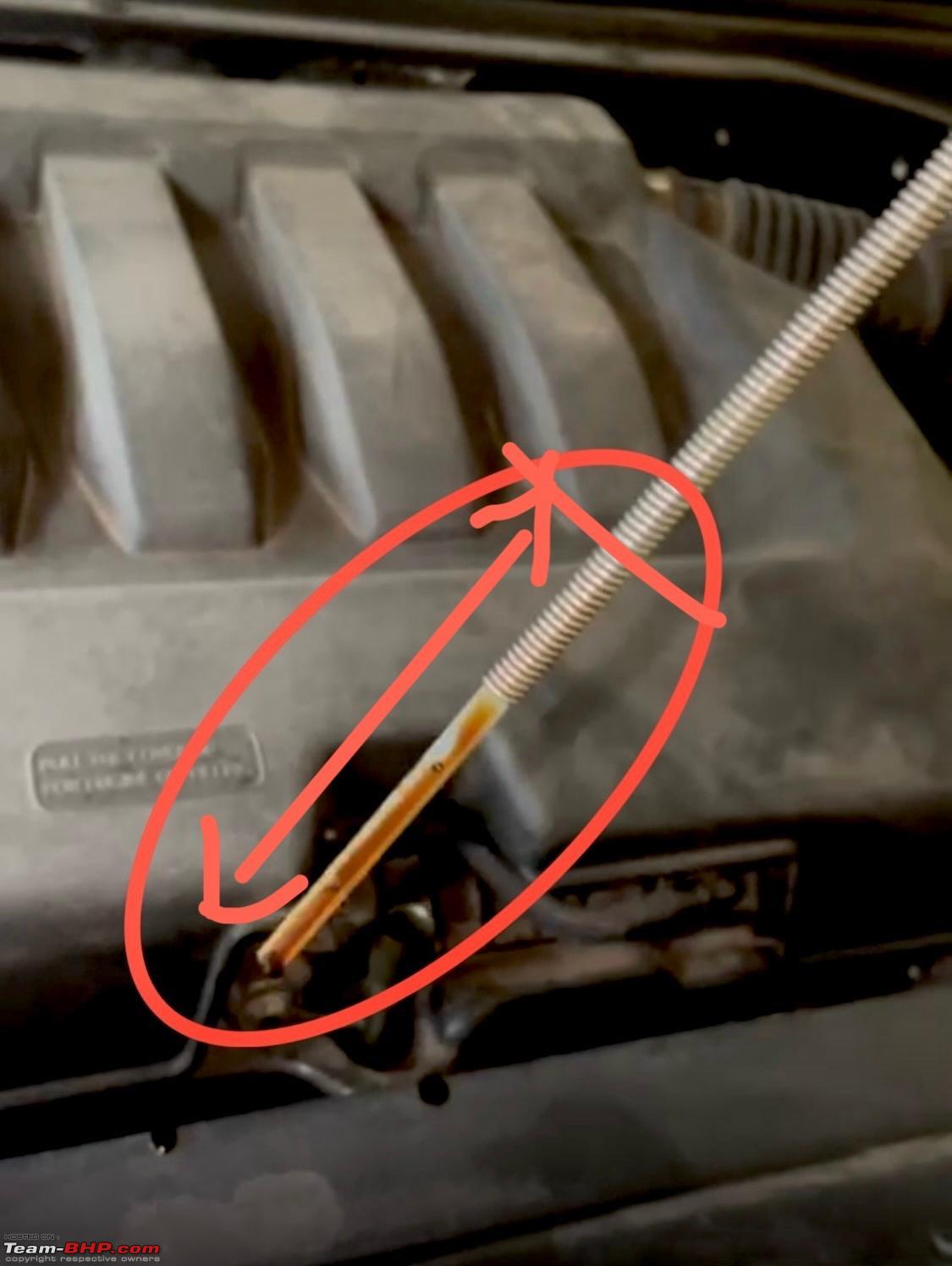

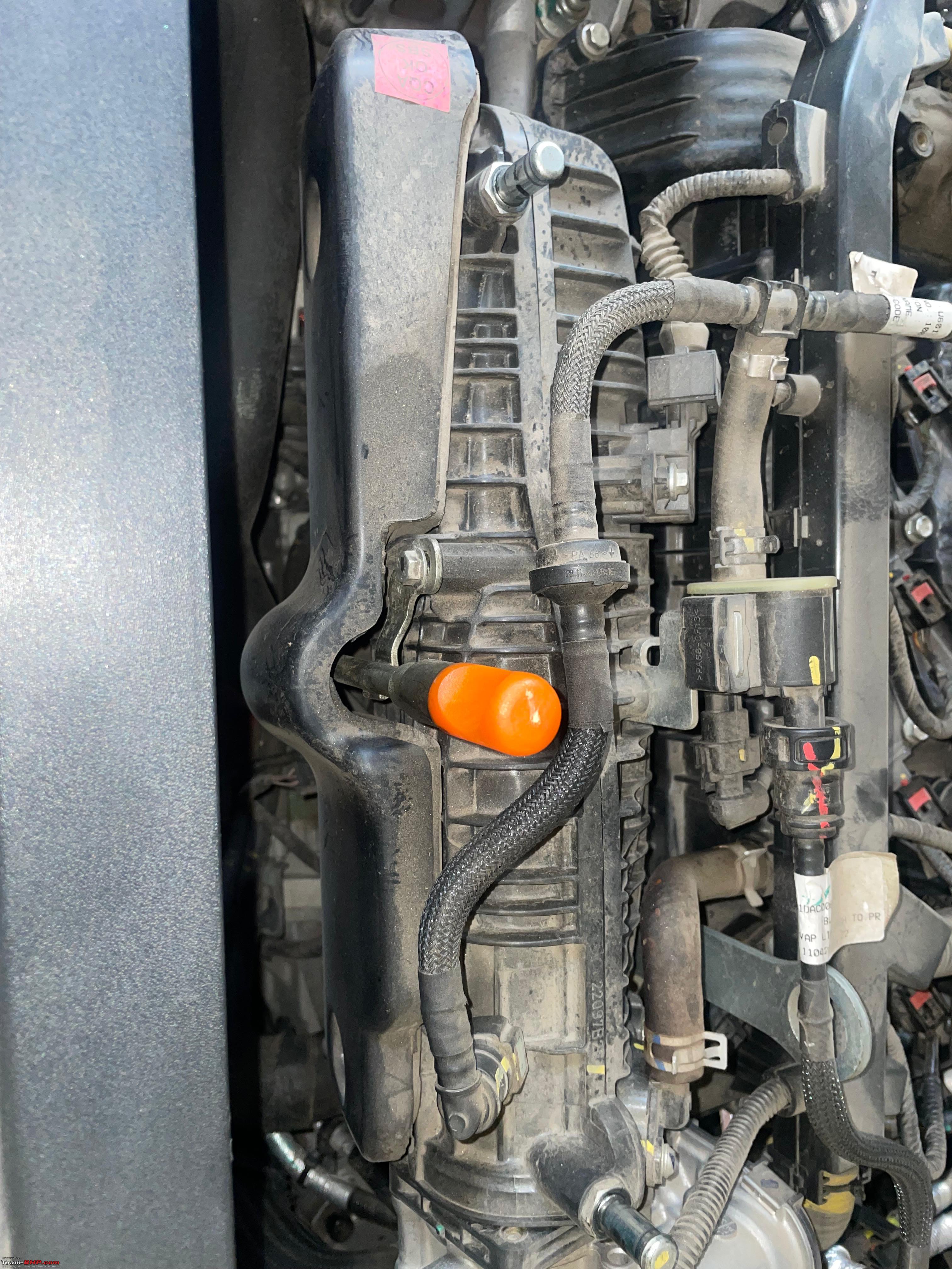

Issue 2: The Engine Oil Mystery
Returning from my cousin's place, I sensed something unusual under the hood. Upon inspection, I noticed engine oil sprayed across certain areas of the engine bay. Removing the engine cover confirmed my suspicions of a potential gasket leak. I immediately shared images with Mr. Dileep for further advice.
Here is some pics of the same:
Mahindra XUV700 (aka Rudra) Initial Ownership Report | Journey from an Eon to the XUV700-whatsapp-image-20250103-7.30.45-pm-2.jpeg
Mahindra XUV700 (aka Rudra) Initial Ownership Report | Journey from an Eon to the XUV700-whatsapp-image-20250103-7.30.45-pm-1.jpeg
Mahindra XUV700 (aka Rudra) Initial Ownership Report | Journey from an Eon to the XUV700-whatsapp-image-20250103-7.30.45-pm.jpeg
Mahindra XUV700 (aka Rudra) Initial Ownership Report | Journey from an Eon to the XUV700-whatsapp-image-20250103-7.30.45-pm-3.jpeg
Given the engine was hot after a 30 km drive, I deferred the oil level check until the following day. To my astonishment, the dipstick showed oil levels exceeding the maximum mark by 3-4 cm.
Mahindra XUV700 (aka Rudra) Initial Ownership Report | Journey from an Eon to the XUV700-whatsapp-image-20250103-7.30.45-pm-4.jpeg
Here is a quick video and a pic on the same:
Upon a quick call, Mr. Dileep attributed this to either improper sealing of the oil cap or could be due to the blowby gases. He advised checking the oil level after a few hours of the engine cooling down.

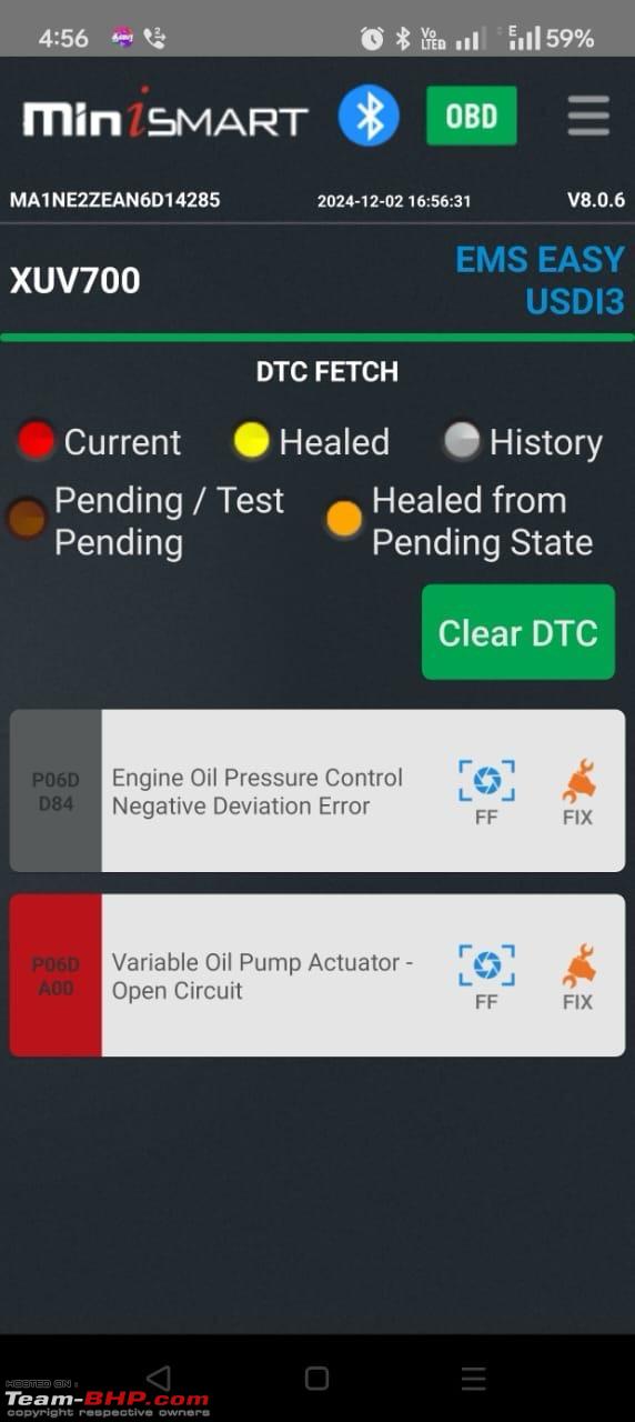

Visit to ASC (Dec 3 - Dec 10, 2024): Dealing the Dual Dilemmas
This alerted myself and Dileep sir, hence we properly documented both the issues and RUDRA was taken back to ASC on Dec 3, 2024 and I was given a loaner XUV700 (the one which I TD'ed for the second in CAI!! Well, good time to catch up with the 85k ran AX7L D AT, which actually relieved some stress of not having an alternate car! Kudos to CAI and Mahindra for this).
Upon arrival of the driver for the pickup, I insisted himd to run an OBD scan via their mini i-Smart tool, which returned error codes confirming potential oil pump irregularities.
Below is the quick diagnostics report.
Mahindra XUV700 (aka Rudra) Initial Ownership Report | Journey from an Eon to the XUV700-whatsapp-image-20250103-7.30.45-pm-5.jpeg
And being it a December, for the pre-planned trip with our cousins, we decided to switch to Ecosport as our 700 was at ASC
For the gear issue, ASC initially adjusted the gear cables and replaced the gearbox oil. They checked for debris or viscosity changes, but everything appeared normal. In a proactive move, ASC lowered the gearbox to inspect the clutch, CSC, and bleeder. Despite their good condition, they have replaced the mentioned parts under goodwill (thanks to Mr. Dileep for the same) just to rule out the doubt on the servicable parts.
Mahindra XUV700 (aka Rudra) Initial Ownership Report | Journey from an Eon to the XUV700-whatsapp-image-20250103-7.30.46-pm-1.jpeg
Surprisingly, the issue persisted, and ASC had to escalate this matter to Mahindra.
On the engine oil front, ASC drained and measured 5.75 liters—perfectly normal. However, due to the error codes, the Control Valve Oil Pump was replaced, and oil was refilled precisely. Yet, the dipstick read high by 3-4cms above the max marking!
Even now, I am not sure where the issue lies, I doubt there has to be something wrong with the dipstick. Reassuringly, the ASC team assured me the engine's health was uncompromised, and a detailed documentation was shared with Mahindra.

Just for curiosity, checked the price of said parts on boodmo:
0303ABG00081N 1892.00
0801CAA01501N 12057.00
0802CAA07461N 287.00
0802CAA08861N 4473.00
TOTAL 18709.00 (INR)
Gear oil 2L 1600.00 (approx.)
G TOTAL 20309.00
What was the reason for oil splash in engine bay? Is it remedied by replacement of ‘oil pump control valve’?
Spot on! I also searched for the same in the boodmo.
btw. the oil splash in the bay was told as a slightly loose engine oil cap and bad oil control valve. Keeping my fingers crossed.
