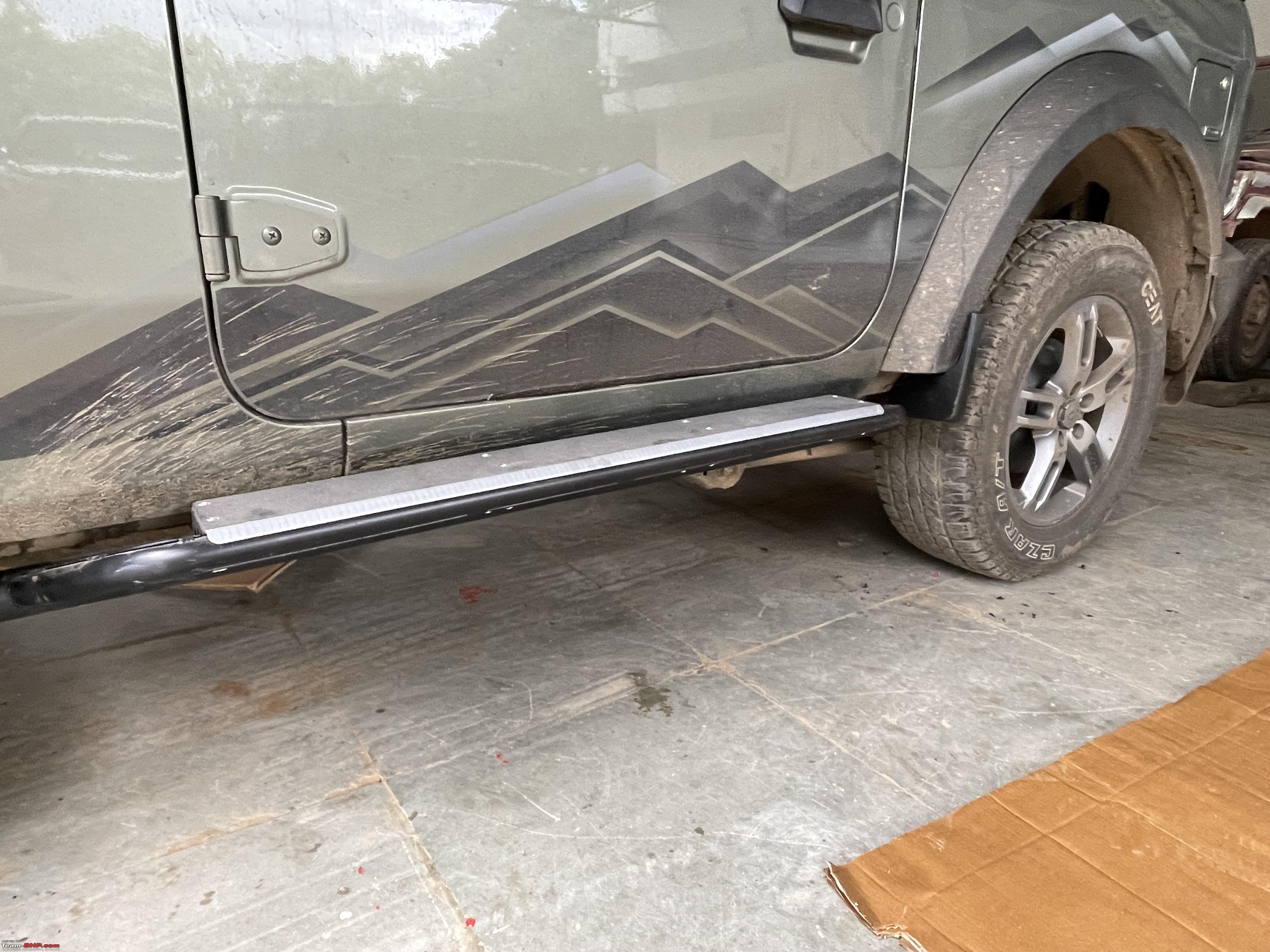

it's been a while since I dropped in to Arka motorsports (wanted their rock slider foot steps), will have a word on this topic when I go in...
Truth be told those rock slider footsteps are absolutely solid. Ive had them since the beginning. They are expensive but worth it in my book.
An alternative is to buy the normal Mahindra Thar AX Tubular Steel footsteps which do the job more or less as well, but at a much lesser price.
My Modified Mahindra Thar 4x4 Review | Red Turbo-Petrol AT Convertible-img_5864.jpeg
My Modified Mahindra Thar 4x4 Review | Red Turbo-Petrol AT Convertible-img_9725.jpeg
