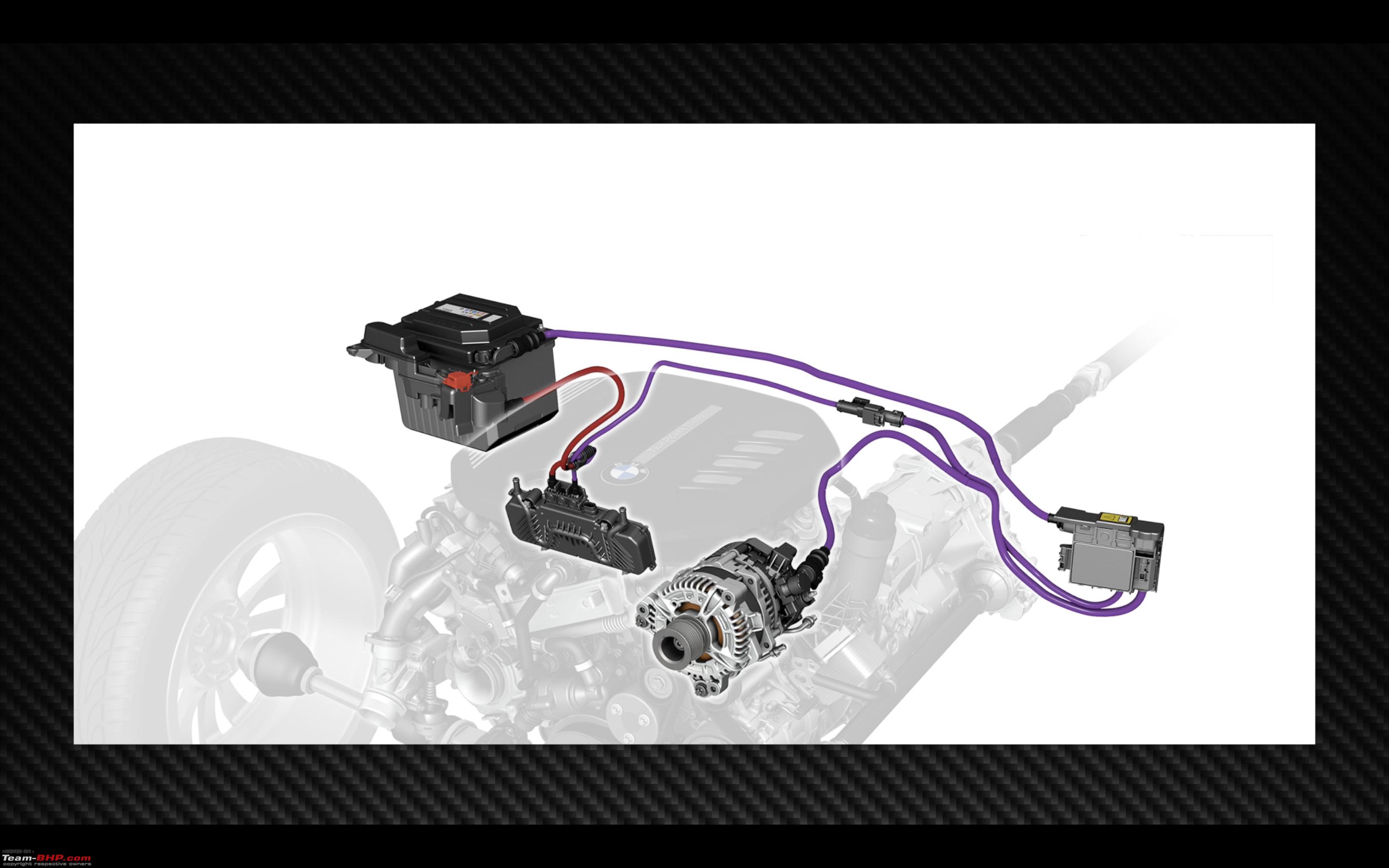

We also need to note that this B57 is assisted with 48V hybrid tech;
BMW X7 40d Review | Driving the B57 engine-screenshot-20240317-11.10.328239pm.png
The main way in which this system saves fuel is by coasting. If your foot isn't on the gas, then the engine is shut off, de-coupled from the powertrain and the car sails (enabling " Sailing " feature which is basically coasting) along. The starter motor can kick the 3L diesel back into life much quicker and with lower vibration (very seamless too) than normal starters. Also, it can help with propulsion under certain conditions. Do note that the dynamic power delivery from the 48V electrical unit measures around 11 hp & is useful also during the start and acceleration phases of the vehicle.
