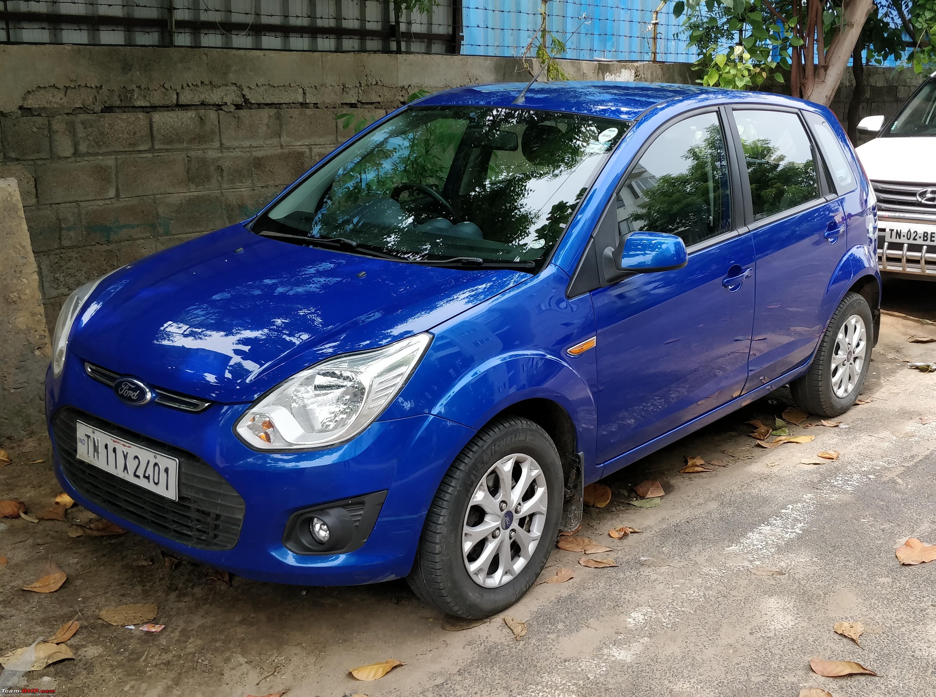

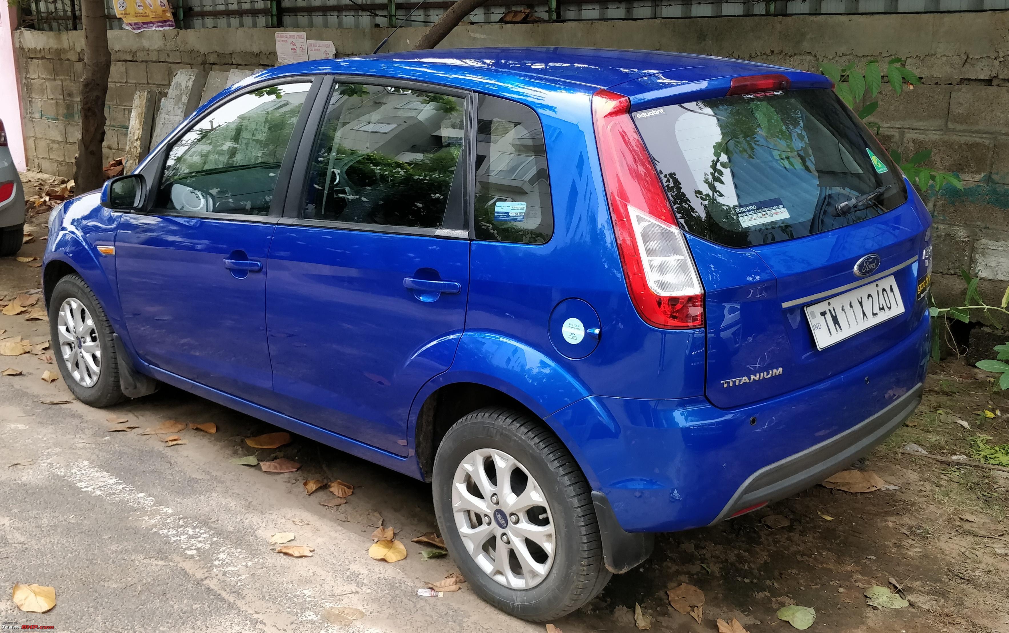

This is Bluey just a few minutes before she was handed over to the new owner!
Review: 1st-gen Ford Figo (2010)-img_20180818_14110801.jpeg
Review: 1st-gen Ford Figo (2010)-img_20180818_14111801.jpeg

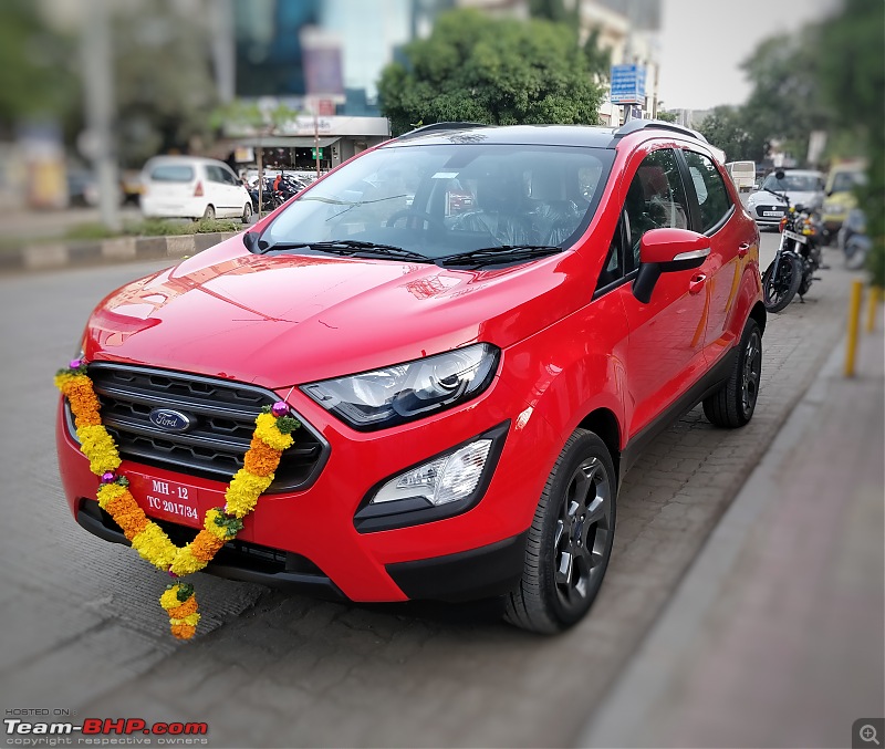

Bluey's big sister. Introducing Paprika!
Review: 1st-gen Ford Figo (2010)-img_20180905_18050001.jpeg
She's not only hot but also as practical as a wife...!!!:D
That said, Bluey looked really good for her age and usage.
Can you post the price break-up and the discounts you got for the EcoSport?
Also, why not the Nexon?
The Figo aged really well and the whole ownership experience was great barring the gear bush failure which I temporarily fixed with my shoe lace to get home!lol: The constant detailing sessions every 6 odd months, kept her all shining as well.
Attachment 1800079
Thought of buying your Figo as a secondary car but decided against buying anything for the time being.
Congrats on the Ecosport. The red is stunning.
While its loaded with features like sunroof, 6 airbags , 14 lakh is bit too much for a sub 4M vehicle. My god, car prices have kept up like anything.
I remember the Ecosport launching at 5.5 L in 2013. My mind seems to associate it only as a 8-10 L vehicle at max . Even the Titanium + seemed to sell for 9.xx for a while.
Did you consider alternatives like Creta, XUV or even a Corolla / Octavia?
