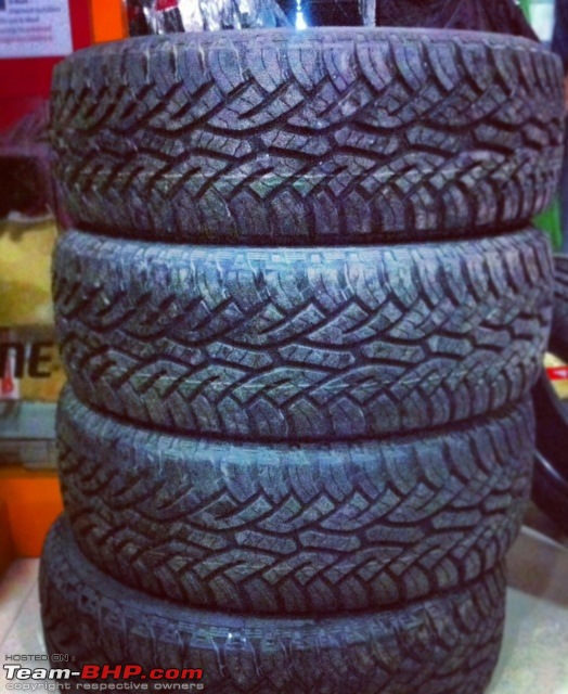

^ I bought these tires for Rs 12,000/Tire from Super Tires (Mulund)

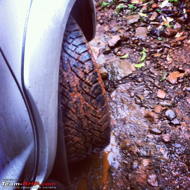

Off Road / Trail driving;
This is where the tires stand out & really one major advantage over the OE Dunlops.
For reference i am showing one pic for reference from my recent OTR outing;
My Fortuner Tyre Upgrade: Continental Cross Contact A/T-off-roading-2.jpg
^ This was the same slushy patch where most of the Fortuners were stuck & even an Land Rover D4 had got stuck.
With these new tires i crossed this slushy up-slope with ease. I remember i had started in HL mode & also stopped midway to engage LL (& that's the time i clicked this pic) , so after losing momentum also the car picked up without any drama & cleared the patch very smoothly.
My Fortuner Tyre Upgrade: Continental Cross Contact A/T-off-roading-mud.jpg
^ Also note the tread design is such that it is always pushing & channelizing the mud out & not letting it form a layer on the tire.

Regarding the donuts, yeah man, very true. In that slush pit i was just like doing back to back U - Turns and not exactly donuts stupid:
Here's a pic of the same for the rest of the BHPians for reference;
