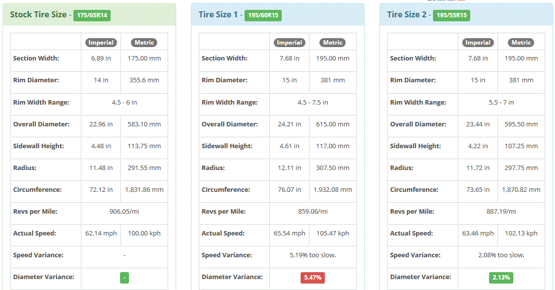

I have just booked the all new FIGO 1.5D and looking at an rim upgrade to 15"ers.
For tyres i have zeroed down on 2 sizes;
1) 195/55 R15 - Will work the best as its available in global markets.
2) 195/60 R15 - What about this option ? Need that extra cushion for Indian roads, but will it fit without brushing / scrubbing in the wheel well under load ?
Originally Posted by karan561
(Post 3824728)
2) 195/60 R15 - What about this option ? Need that extra cushion for Indian roads, but will it fit without brushing / scrubbing in the wheel well under load ? |
Congratulations on the Figo, the little diesel bombshell :)
195 mm wide tires make a ton of sense for the power of the diesel. Coming to the profile, I'd personally go for the 55 profile given its a known/official size, even though Ford India don't offer it here.
If you see the below comparison of stock vs. the 2 sizes you're considering:
- Notice how the overall diameter of the tyre+wheel increases significantly over stock for the 195/60 R15 (22.96" stock vs. 24.2"), as opposed to the preferred upsize of 195/55 R15 (23.44")
- The variance in diameter for 195/60R15 is a significant 5%, well beyond the recommended 2-3% range.
- While we cannot say if either of these points will cause scrubbing by itself, its something you'd want to check if you mount the wheels, by turning the steering lock-to-lock when on the ground.
- 15" rims + tyres with this profile will increase the unsprung weight of your car.
- If the comfort/cushioning for Indian roads is what you prioritize over appearance, then best to stay on 14" rims. If its appearance, then go for 195/55 R15, and experiment with tire pressures to get good comfort and performance.

Originally Posted by arunphilip
(Post 3824846)
If you see the below comparison of stock vs. the 2 sizes you're considering: Attachment 1426815- Notice how the overall diameter of the tyre+wheel increases significantly over stock for the 195/60 R15 (22.96" stock vs. 24.2"), as opposed to the preferred upsize of 195/55 R15 (23.44")
Source: http://www.1010tires.com/Tools/Tire-...0R15/195-55R15 |
Hey,
Thanks for your comments,i already had referred 1010 on this but don't you think that we also do have to consider that the car's suspension is tuned for Indian conditions so will not be as low as the EU spec, so doesn't that mean it may accommodate 195/60 R15 ?
Also i can't stick with that 14" setup, because i have picked the TREND specifically saving money for tyre/rim upgrade :D
(Post 3824957)
but don't you think that we also do have to consider that the car's suspension is tuned for Indian conditions so will not be as low as the EU spec, so doesn't that mean it may accommodate 195/60 R15 ? |
Fair point - but that's something best checked with the car and wheel itself. You can ask the tire guy to put one of each size on each side of the front, and then turn the steering lock-to-lock to see if there's a difference.
