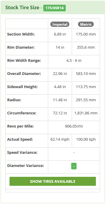

Ford India has launched the all-new Figo (hatchback) and Figo Aspire (sedan) in Aug/Sep 2015. Both cars come with a stock tyre size of 175/65 R14 across all variants and models. In a break from the norm, Ford have not used tire size as a variant/model differentiator. So, whether you get the base Figo, or top-end Figo Aspire, the tire size is always the same.
While a consistent size might be beneficial to Ford India, in terms of supply chain, it turns out to be a sore point for us consumers, because:
In this thread, we can discuss potential upsizes of tires, as well as different brands.
Size Options
For the recommendations below, I've not gone for too wide, or too large tires, as they're likely to bring other problems. Size comparison from 1010tires.com: http://www.1010tires.com/Tools/Tire-...0R15/195-55R15
Tire Options
I've listed matching tires from Michelin, Pirelli, Continental and Yokohama, along with a link to their sites. I've intentionally not provided any prices, since that can vary due to a variety of factors. Members can post about quotes they've received from different dealers.
175/65 R14 (stock size on stock rims, not an upsize)
Name:  175_65R14 Stock.gif
