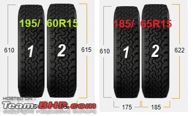

195/60R15 is the correct size for Ignis from the Upsize recommendation perspective, check the comparison below:
Upsize Comparison
The circumference deviation should be < 2% which makes the 185/65R5 a borderline case while the 195/60R15 becomes the correct choice. Also note that GC does not reduce with 195/50R15 but increases marginally.
Thanks for this and the photos, have got some clarity now. I have to do an Uttarakhand hill run in the next two weeks and want to change to a wider set of tyres before that. Basically, my choice boils down to two: A) 185 60 R15 and B) 195 60 R15.
Case A entails a lower ground clearance, which I'd like to avoid. Also, have a feeling that if am spending on good rubber, why not go for 20 mm upsize instead of just 10 mm, which may or may not give much difference in real-world handling. However, the 185 looks aesthetically nice, neither too wide nor too thin.
Coming to Case B, 99% I will go with this one as the overall diameter is the least affected and ground clearance gain is very marginal (in the already tall car). But - a big but - being a chaser of aesthetics, am still unable to get a handle on how the 195 will actually look from front and rear. Would they extend out too much, giving an eyesore, like those some Swift boys who slap tractor tyres in chasing the wider dream and end up looking hideous?
Would it be asking too much if I request you to add two-three more photos, whenever you're free, of your Ignis shod with 195 taken from the front and rear in good light where the tyres and how much they are sitting inside/outside the fender are clearly visible? The above two photos are really good, but they don't show an indication of how wide the 195 look in Ignis from the front or back.
So it's obvious that the technical part is sorted, that is I am going for 195 60 R15, but I'd still like to see the "looks" part of it. It will give some peace to mind to know before I take out my wallet.
Will check out Yoko Earth-1, Continental CC5 and Bridgestone B290 - a balance of hard and soft compounds.
