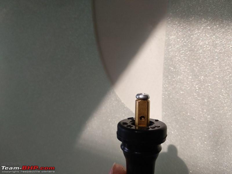

Another thing you need to consider is, the availability of Valve steps for your TPMS module and its quality. I have MGA promoted Schrader made TPMS, and some of the downsides I noticed are:
1. If your valve leaks, you have to change the entire sensor assembly which costs anywhere between 2-4k per sensor, depending upon brand.
2. If you have to change the rim for any reason, same issue again. Since Valve stem isn't available separately for most brands(except Sensairy IIRC), you have to change the entire assembly.
3. If your sensor battery dies down, same sensor unit needs to be replaced.
Basically there is no child part available. I did my research and came to know that even Mahindra vehicles use the same sensor, and for any issue, they have to follow the same procedure.
In US, Schrader sells TPMS service kit which includes separate valve stems, screws etc. But no such kit is available in India.
This is how the internal Schrader sensor looks:
Also, there are chinese valves available for Schrader TPMS but somehow I won't trust them for something as important as tyre.
To answer your question,
2. Is it possible to screw the OE fitted Valve Stem with Sensor part of TPMS?
Considering your query is for an internal sensor, NO.
Shashi

Thanks for the prompt reply. This is the sensor,if the image helps:
Leoshashi is offline   (3) Thanks
