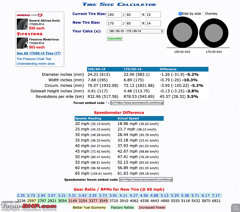

Post downsizing wheels, speedo would need recalibration otherwise the smaller wheel would obviously indicate higher speeds.
Here are 2 comparo charts from Tacoma world.
What happens if I downsize the wheels on my Punto from 195/60/15 to 185/70 and 175/65/14 respectively. See how enthusiastic the speedo gets with a 175 section 14 incher!
