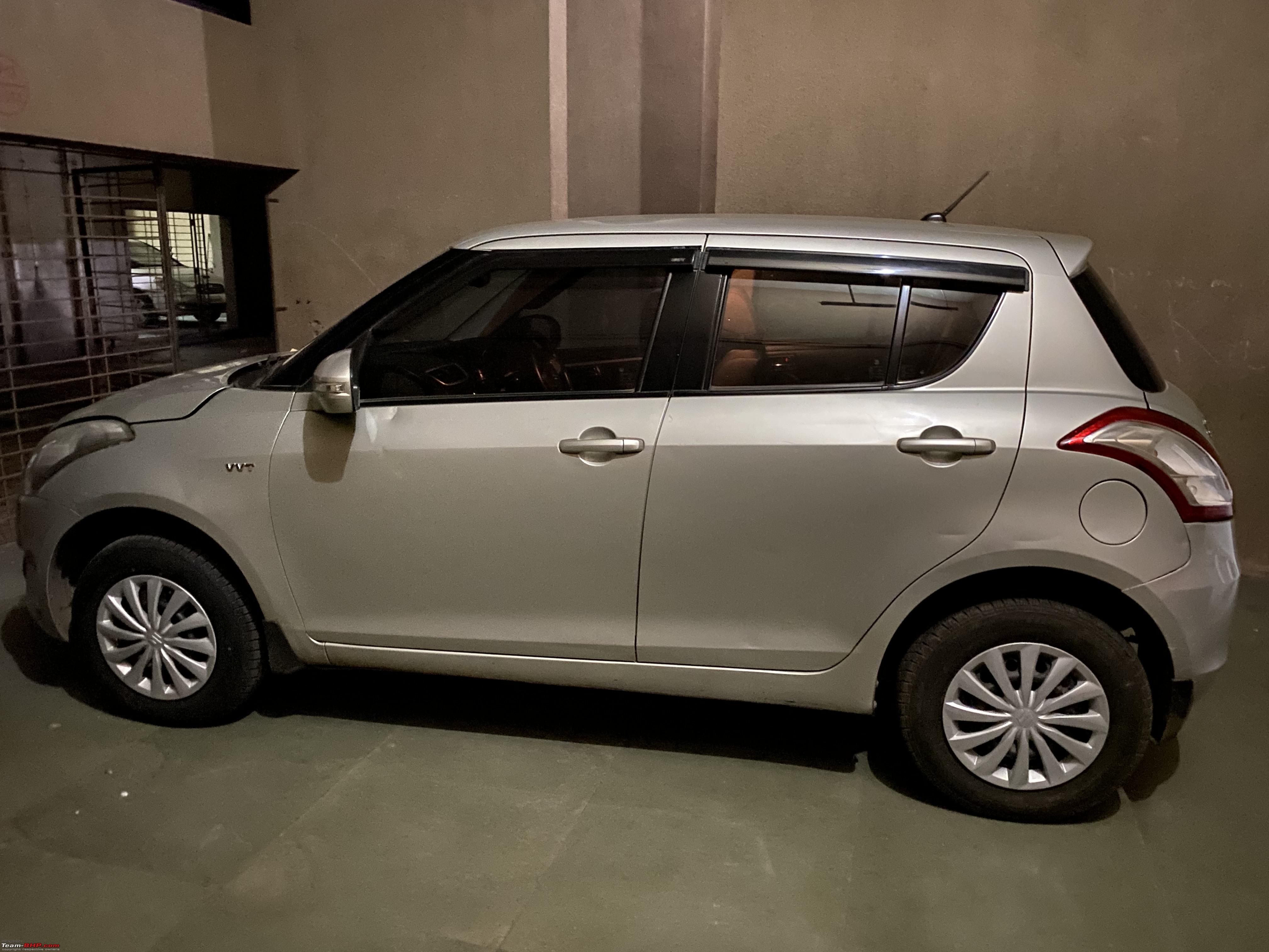

Thank you everyone for your valuable inputs Sorry for my delayed response, my car met with a small accident, the truck ahead of me braked suddenly and the right portion of my car hit the truck and he flew on the spot. The car is once again in the service center now.

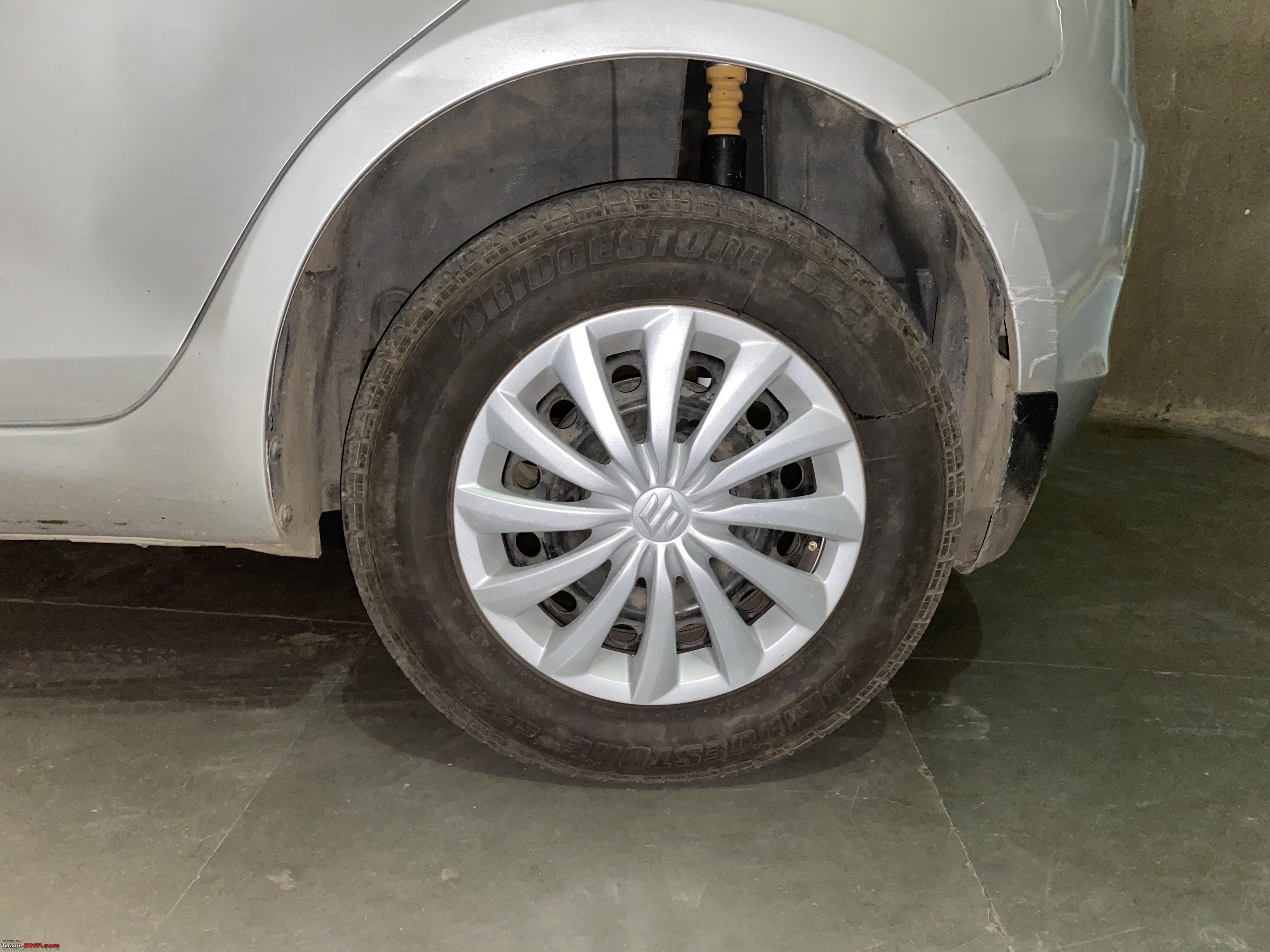

Also, quick update - the bulge in the front portion has considerably reduced now that I have replaced the tyres with the CEAT Milage x3 and I have pushed the Bridgestone tyres to the back. Also one of the Bridgestone tyres had a faulty valve and I have replaced that too. The bulge is barely there now at the rear.

One of Bridgestone tyre wheel rim is very slightly bent and when I showed it to the tyre guy - he said it is nothing to worry. I shall post a pic tomorrow as it was dark and I couldn't click a clear one

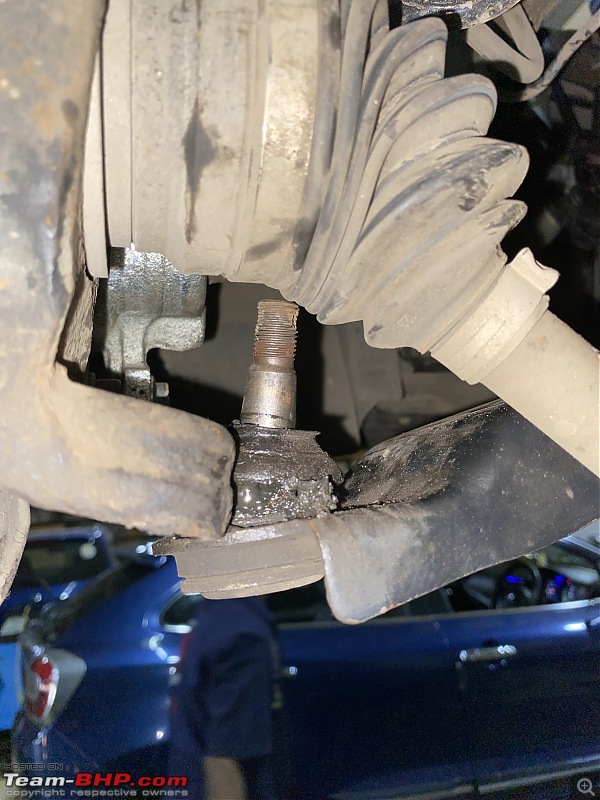

Also check the lower arms for any cracks in the rubber bushes. Minor cracks are ok. On Swift, these bushes cannot be replaced and you need to change the lower arms if the cracks are long. Each lower arm costs around Rs. 1500 for Swift. Normally, the service center will inspect the lower arms while changing the front shock absorbers.
I think this is the only thing left to replace now along with the ball joints. I am not sure if ball joints can cause these problems but a few weeks back I had shown the car to another service center and he mentioned ball joints had to be changed but the guys at the Fortpoint Service (my current MASS) tell me that if ball joints had problem, the car would make loud noises and the steering would vibrate (both of which do not happen on my car). The rubber bush of my cars left arm is broken - please see the pic below but the MASS guy says there is no Play inside and it's still usable.

I have a feeling it's more to do with the steel rims rather than the tyres. Over time steel rims tend to "run-out" more compared to alloys and exhibit some of the symptoms you have described.
Off late, even I am of the opinion it could be the rims as I found a small dent in one of the Bridgestone tyre rim but the tyre guy told me it's completely fine and nothing to worry.

Here are the pics of the accident, the tyre change and the lower arm bushes I inspected in the service center. The mechanic told me the bushes are broken but there is no 'play'. Should I go ahead and change both the lower arms and also replace the ball joint?
A lot has happened to this car and I will keep you guys posted on how things proceed. Once again, thank you for all the inputs and suggestions

I suggest you check for similar issue on the Bridgestone tyres that you moved to the rear. Simply get the tyres on a jack or a lift and check for undulations on the tyre surface.
