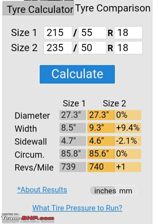

Re: Hyundai Alcazar | Tyre upgrade options
Originally Posted by funda2max View Post
I will be getting Hyundai Alcazar in about two weeks, looking to upgrade to a better brand tyres. It comes with JK tyres 215/55 R18. Can you please suggest options available ?
Guess you want to upgrade the size too. If so, 235/50 R 18 would be a good upsize that would retain the stock diameter. A quick look at Michelin website shows the size is existing. However, you may want to check if it's available in the market owing to supply shortage for imported tyres. You can ring up Madhus tyres and check it out. Few months back they helped me source a fifth tyre (Michelin Primacy 4) for my car. In case you are buying Michelin, I would suggest you buy five tyres keeping in mind the possible scarcity in supplies later. The size is available in Continental and Yokohama too.
Hyundai Alcazar | Tyre upgrade options-screenshot_20210731204703_samsung-internet.jpg
Thanks. Checked with Madhus and got to know that they don't have supply of this Michelin. They have Yoko C Drive available though...
