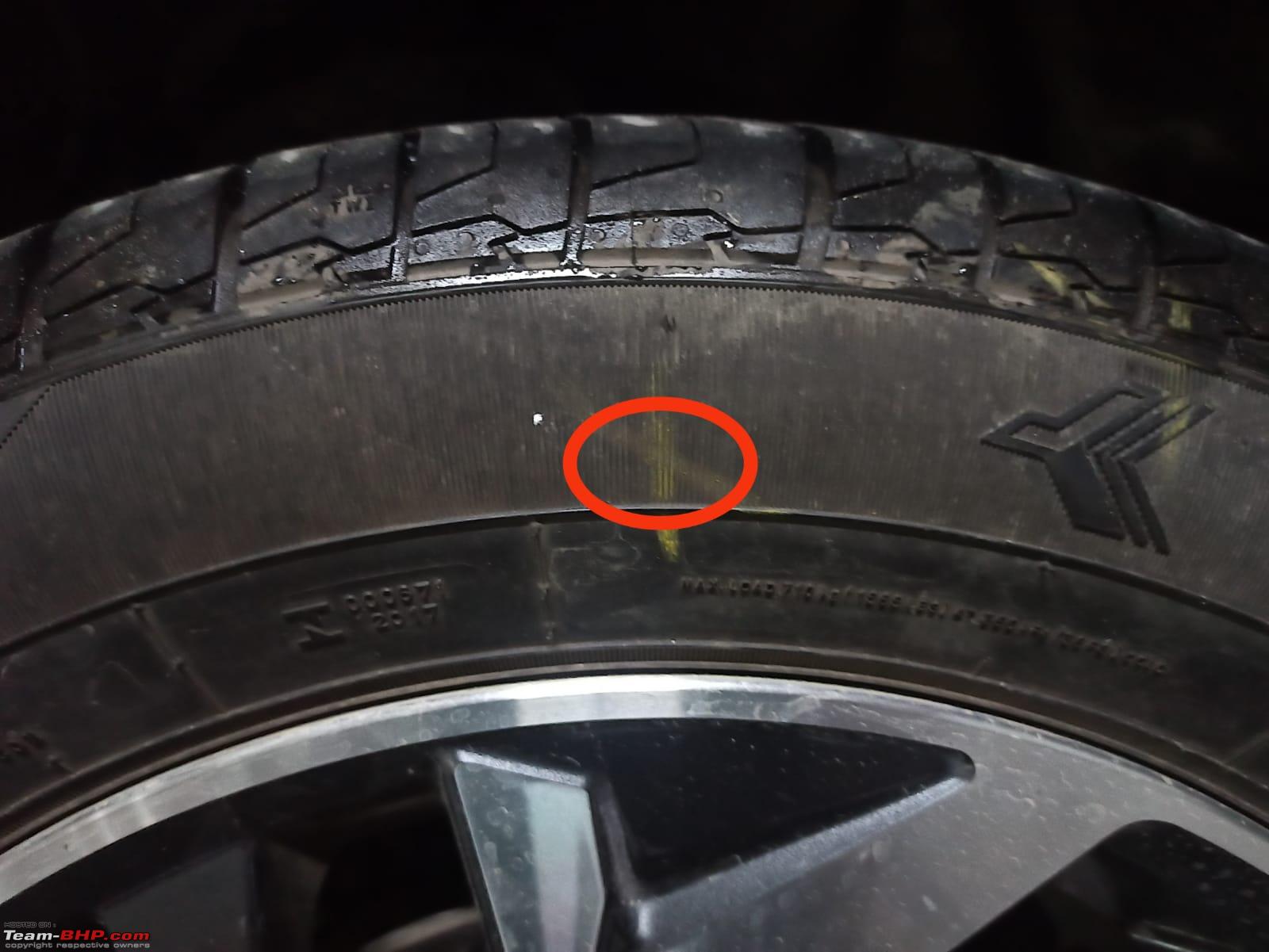

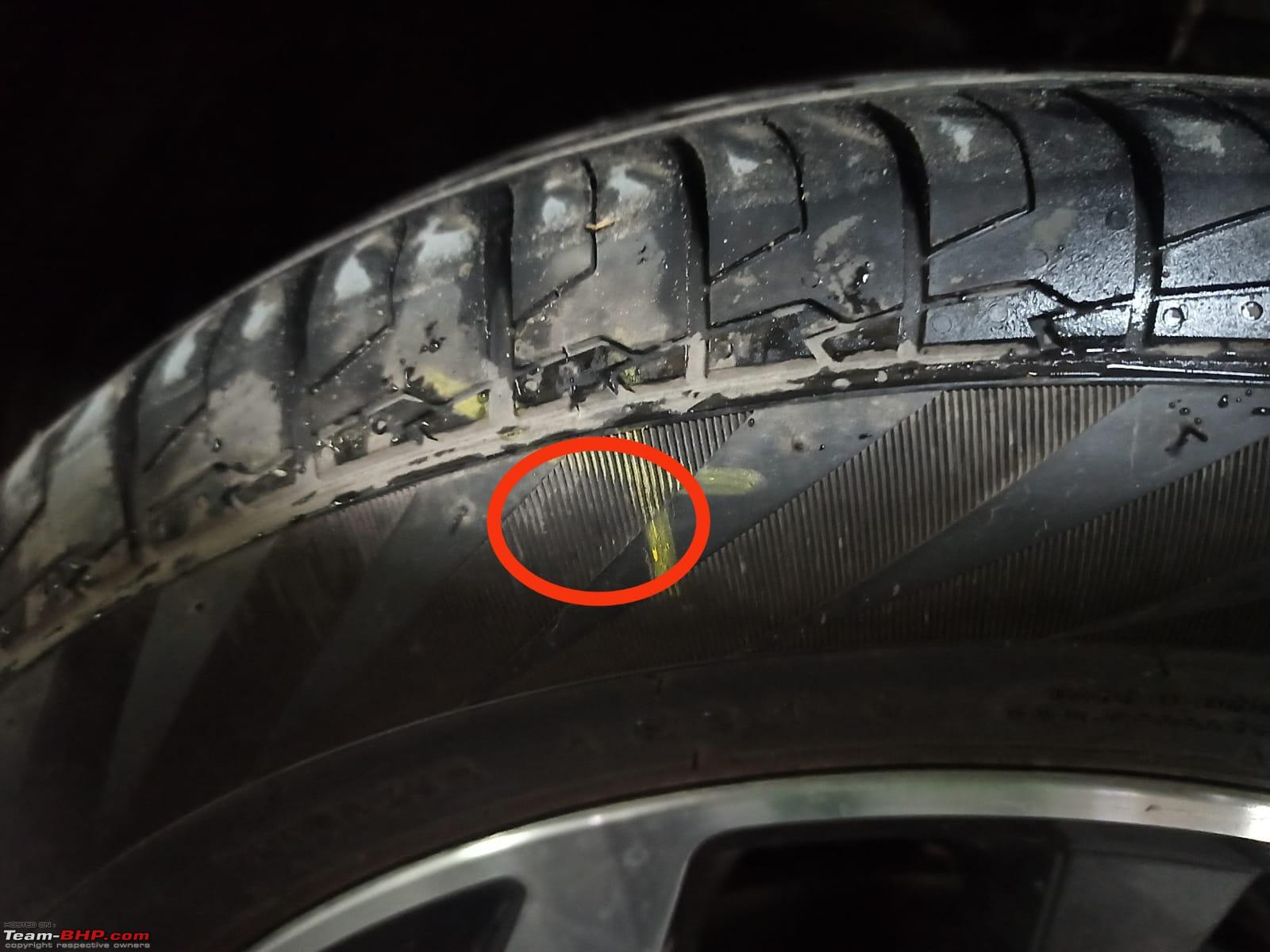

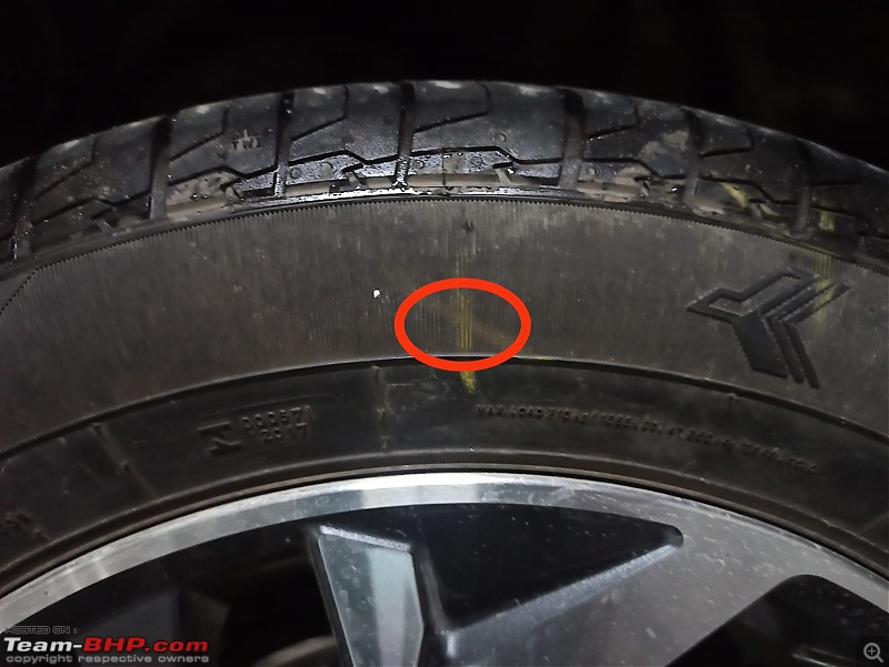

I had been observing very mild loss pressure in one tyre of my 2021 Creta within 2-3 months of buying the car. I initially attributed it to minor leakage from valve as it only went down 1-2psi compared to the other 3 tyres. It was not affecting the driving and did not require constant refilling. Considering that the car has a highline TPMS sensor, i was putting off the checking/replacement as i did not want to get it done on the roadside.
Last week, the pressure started going lower than usual and so i didn't have an option but to take it to a puncture shop. In addition to a puncture due to a rusted nail, we observed 5 spots on the sidewall on either side from where there was a very slow leakage (picture below).
Sidewall issues, Warranty or FNG? | Update: JK Tyres replaced tyre under unconditional warranty-tyre1.jpeg
Sidewall issues, Warranty or FNG? | Update: JK Tyres replaced tyre under unconditional warranty-tyre2.jpeg
On both sides, this is happening on the ribbed line portion. The repair shop guy told me that he will have to take out the tyre and fix these from the inside. Before going for it, i wanted your opinion on some points:
1. This does not look like a regular puncture and unlikely to be caused by road conditions or wear & tear. 2 leakages are on the outer side while 3 are on the inner side of the tyre. Could this be a manufacturing defect and will it be covered under warranty?
2. For tyre warranty claims, do we approach the car dealer or contact the tyre manufacturer or their authorized seller?
3. The tyre shop guy said it could be someone using a sharp object (but how would they do it on the inner side of the tyre). During the last service, i got the tyres rotated. Can this damage happen during tyre removal and refitting?
4. Should i just leave the hassle, spend Rs 1500 and go for sidewall puncture repair?

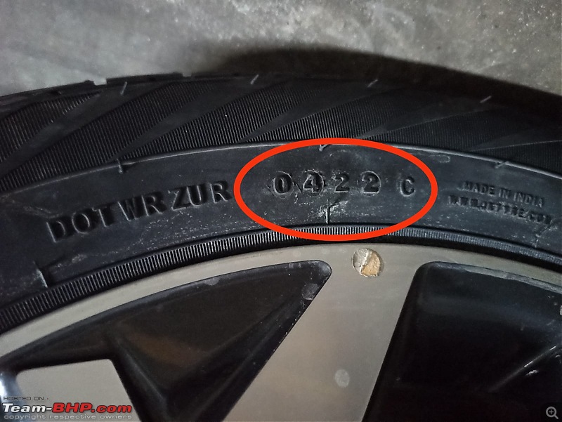

Hoping this is the Mfg month & year:
Sidewall issues, Warranty or FNG? | Update: JK Tyres replaced tyre under unconditional warranty-tyre-5.jpeg
Attachment 2353640
Small correction - it is the Week and year code, which means it was manufactured in the last week of January.
