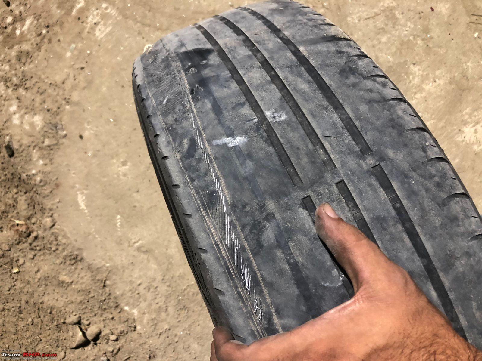

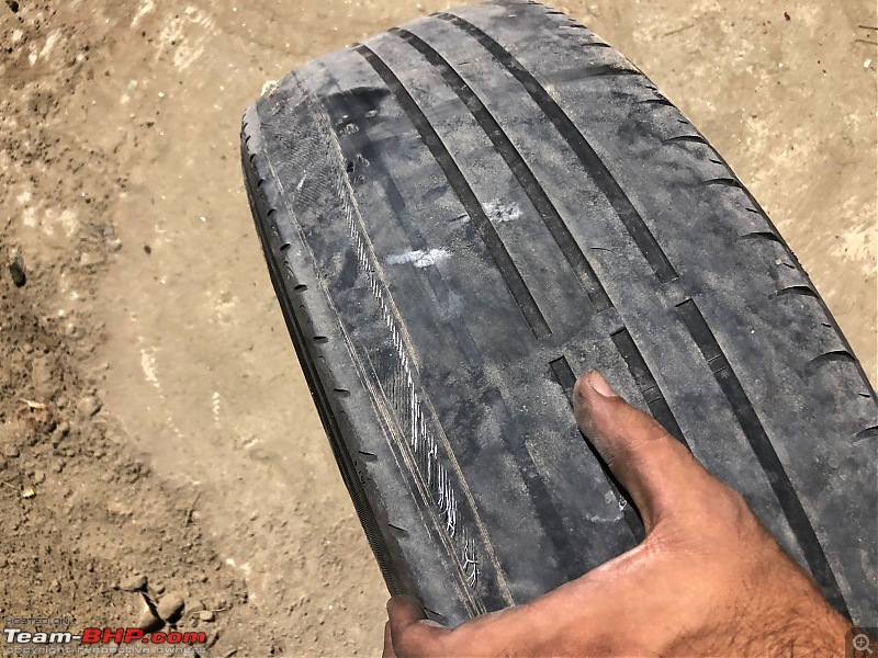

Oct '22 – The car would have done about 24k kms. I was on the highway driving back home from Delhi, when something felt amiss -like the one of the tyres has suffered a puncture. Stopped to check, and found one of the rear tyres to have completely worn off. Note this was at the fag end of the journey and I had already driven the car for about 600 kms that day. Reported the incident to the Kia dealership and on their advice got fresh new tyres at the front and the existing front tyres were put on the rear. Thereafter the tyres were aligned and balanced at the dealership.
The completely worn tyre:
Kia Carnival - Peculiar issue of only the rear tyres wearing off-fully-worn.jpeg
Dec '22 - 30k service. The rear tyres looked to be in not so good shape and on the advice of the dealer just a day before the 30k service appointment got two new tyres. This time the new tyres were put on the rear. Also, as part of the service all four tyres were aligned and balanced. The dealer also checked the rear suspension and ruled out any issue with the suspension. The car's odo reading was about 29.5 k kms.

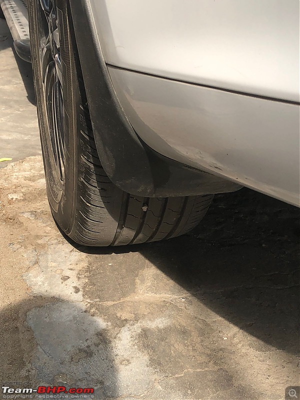

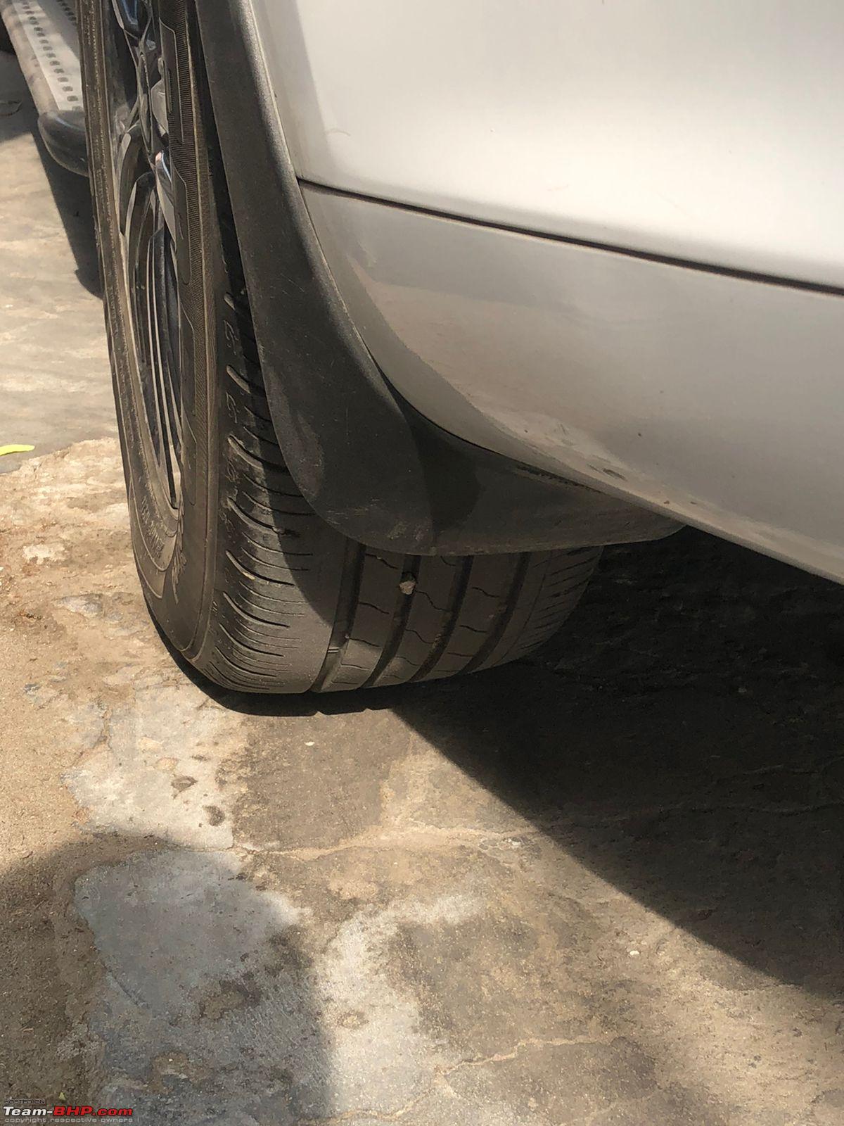

First Carnival
The rear tyre - outer tread line missing
Kia Carnival - Peculiar issue of only the rear tyres wearing off-carnival-1-rear.jpeg

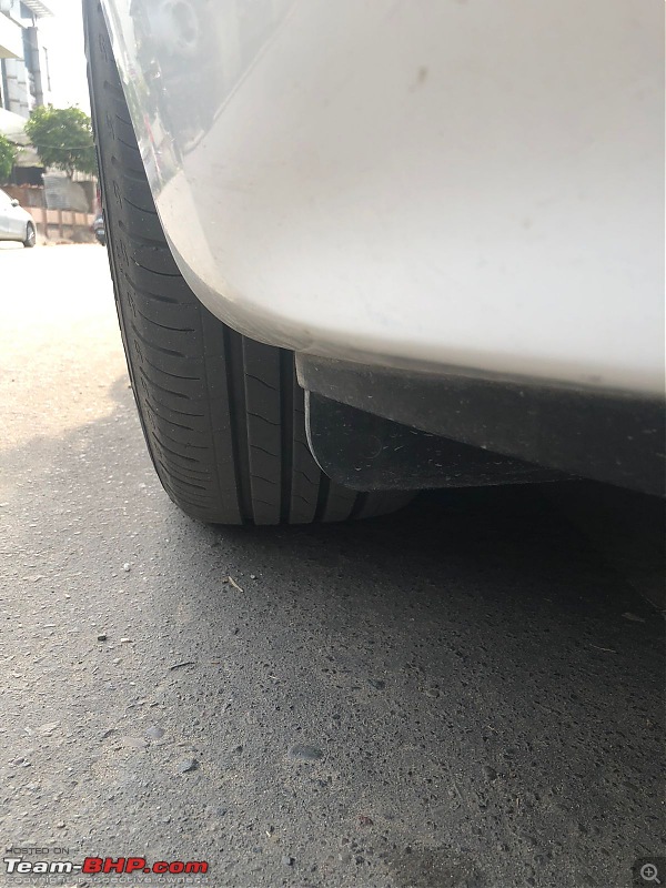

Second Carnival
Kia Carnival - Peculiar issue of only the rear tyres wearing off-carnival-2-rear.jpeg

To me this looks like some scraping / fouling with the naked eye.
