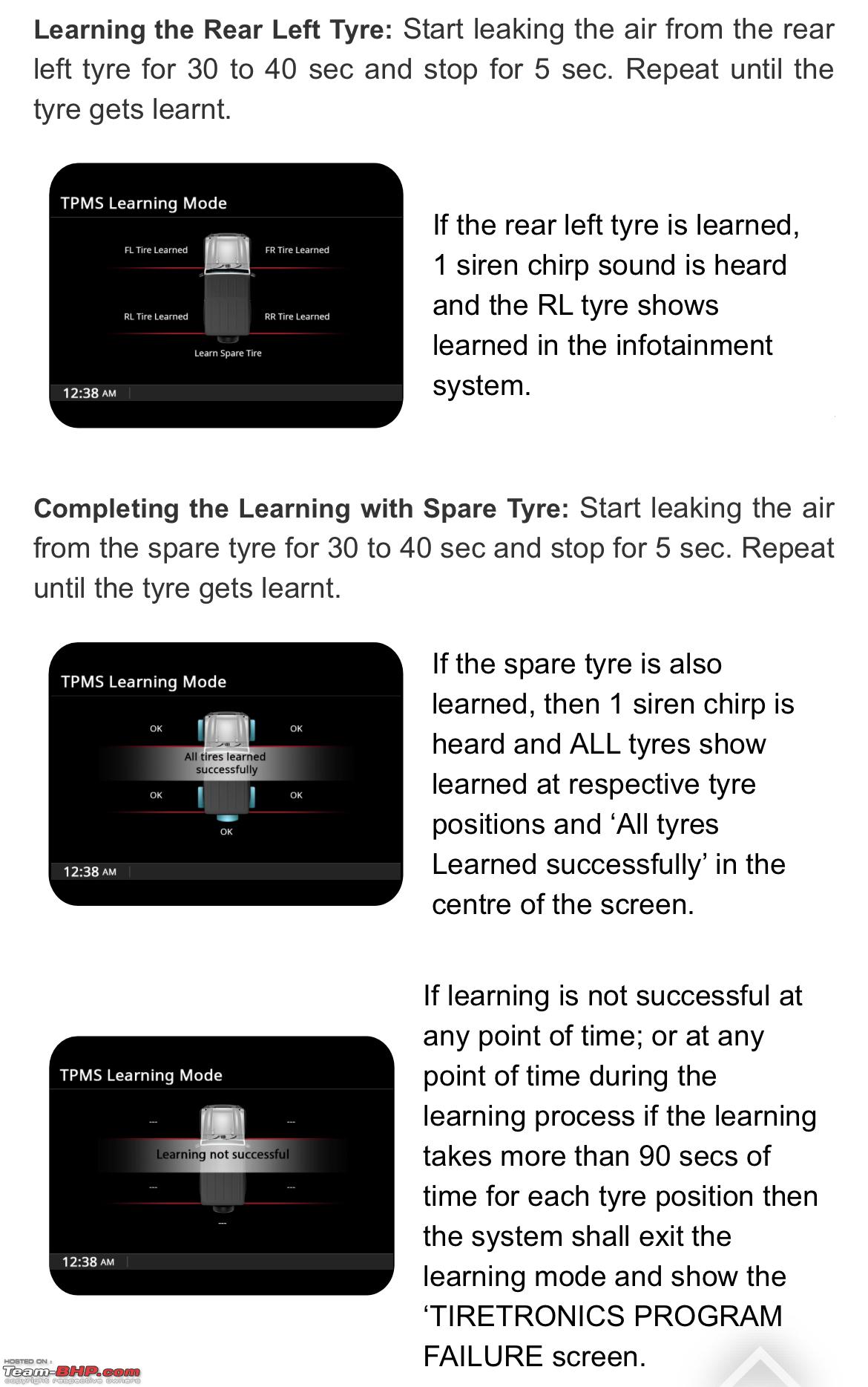

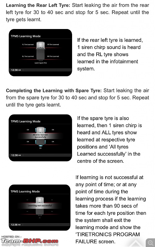

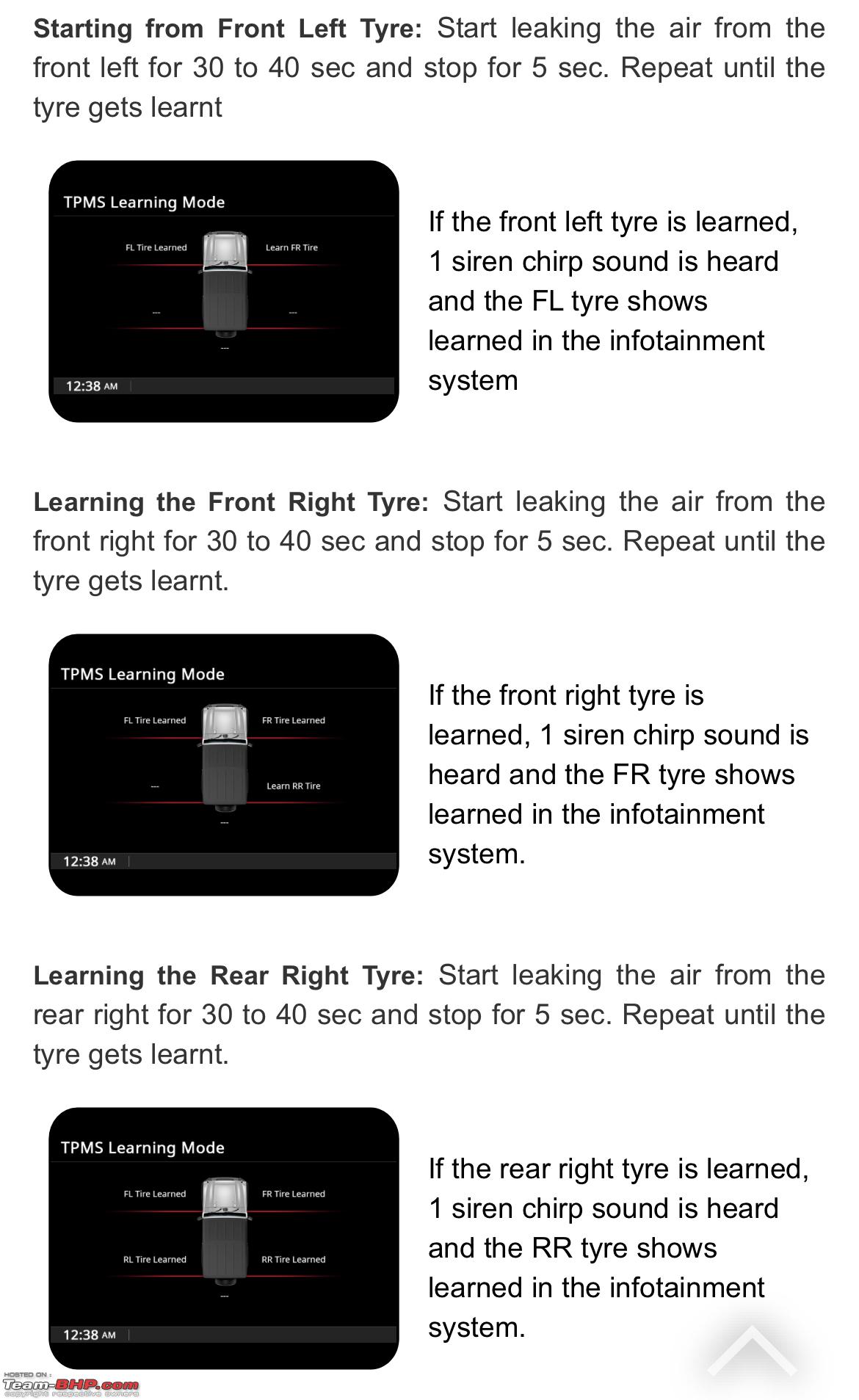

The process for restting the TPMS must be there in the owner’s manual. Here’s what it says for Thar !

NomadSK is offline   (11) Thanks
