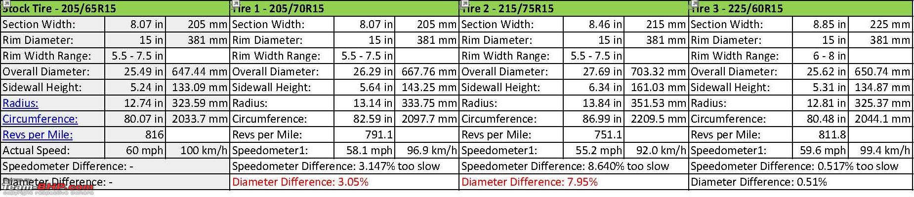

I know of a guy whose Innova is shod with these. He uses the vehicle over kuccha / village roads, so is only concerned about ruggedness and increased GC. Yoko has 2 designs in this size now, check pic for reference.
Can you share info on which one is better for Innova? What are the effects observed of these on Ride and Handling of Innova? What are effects on the ODO, Speed, Tacho and how does this person adjust to the aberration in these?
Will greatly appreciate if you can provide any incite on the above since you have first hand info on the same.
The reason is there is pretty high difference in the profile 205/70 instead of standard 205/65 for Innova.
From 1010tires.com:
Toyota Innova : Tyre & wheel upgrade thread-1010tires.com-innova-tires.jpg

Sorry boss, The car owner only wanted higher GC and a rugged tyre. Wasn't bothered or interested in the details.
