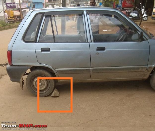

One of the famous alignment centres in my town is known for its hit or miss service. Countless cars have lost their lug nuts, bolts and even tyres because of their carelessness. Whenever experienced folks handle the cars, the alignment is spot on. But more often than not, skilled human resources are in scarce supply and customers are forced to go back repeatedly until one day we get fed up and end up searching for some other place.
The lone MRF T&S centre is also short staffed and hence its always a Hobson's choice.
Today, I saw my own car being reversed from the alignment bay with the sensor plate still attached to the rear LHS wheel :Frustrati. As soon as I realised this, I shouted and the car was stopped; a preliminary inspection revealed no visible damage to the tyre or the sensor.
Cursing him, I turned around to witness this:
Nothing wrong, right?
Wrong!
The tyre is being removed with a small rock acting as a stopper.
Wonder when/whether things will change :deadhorse.
