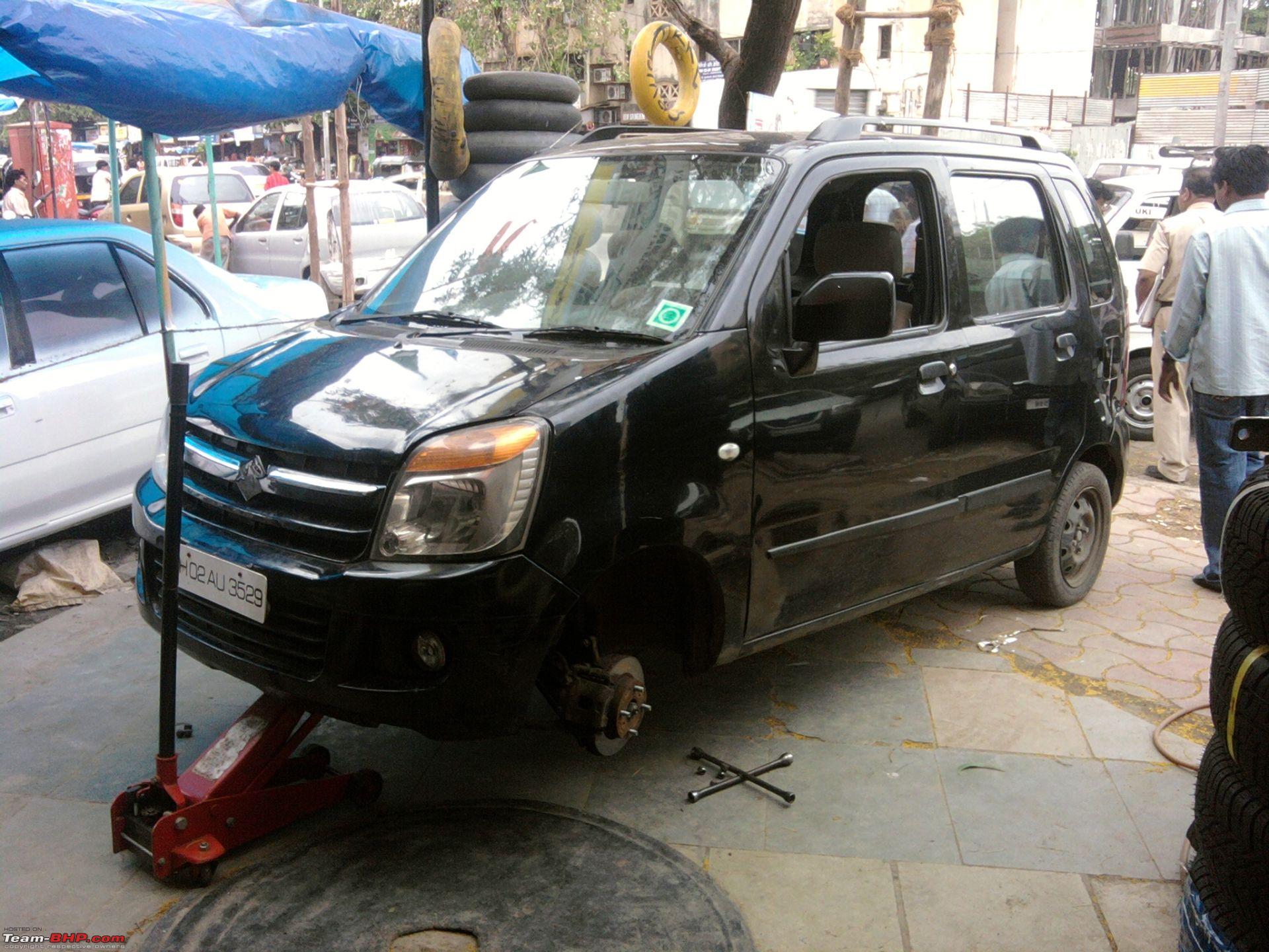

Mom arrived and i told the guy to get on with it.
In a matter of around 1 hour the work was done.
Replacing the 4 tyres, wheel balancing and alignment also done.
The bill was made as per 2.4k per tyre (2.2k for tyre and .2k for new valve) + some 1k-2k for balancing and allignment.
Have driven the car with these tyres for around 5k kms and i am still testing them , they grip the car really well, i opted for 165/70/R13(155/65/R13 stock). Wanted wider as there is nearly 60 kms of highway driving every alternate day and also wanted more comfort.
The steering is slightly heavy now, but the grip levels are amazing, you can actually compare to xm1s, atleast the grip levels, have driven them hard only on 1 occasion, just a few days ago, and they provided amazing grip, i am now starting to repeat myself, but THE GRIP LEVELS ARE TRULY AMAZING, and i can not say more, comfort has also increased, but that is for mom and not for me.
Here are a few pics of the process, and later of the old tyre vs the new one.
