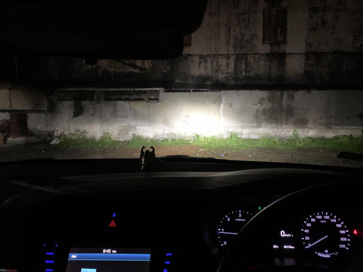

and finally, for the result:
Low beam and High beam
This is definitely what I was looking for! They are pretty bright even with streetlamps and other cars around so I have them angled downwards more than necessary to ensure I don't accidentally dazzle someone coming up a hill or while going up a speedbump.
Just look at the light output!
Flashing your lights actually makes even the most inconsiderate driver hurry to dip his headlights. No more being blinded by oncoming SUV drivers or idiots on those new Activas who drive around everywhere with their brights on. Even slow-moving cars hogging the right lane give way when you flick on the high beams and light up the interior of their car like there is a tube light in the back seat
They work well in medium rain too but can struggle when there is extremely heavy rainfall. To be fair, that was also the kind of rain where traffic slowed to a crawl and had their hazards on so I doubt halogens could have helped much either. Low beams were mostly fine but switching to high beams refracted the light right back into my eyes which made it seem like there was a solid white wall a few feet in front of the car.
