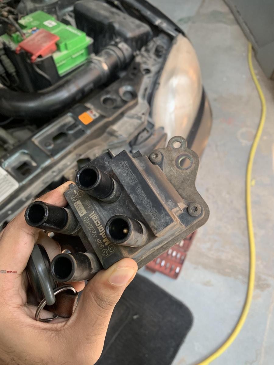

Got in touch with BHPian Viraat13. His trusted mechanic had a detailed look at it and concluded that it was actually the ignition coil that had failed. While it was good news that the problem was minor, the ignition coil for a long-discontinued car from a defunct manufacturer wasn’t going to be an easy find.

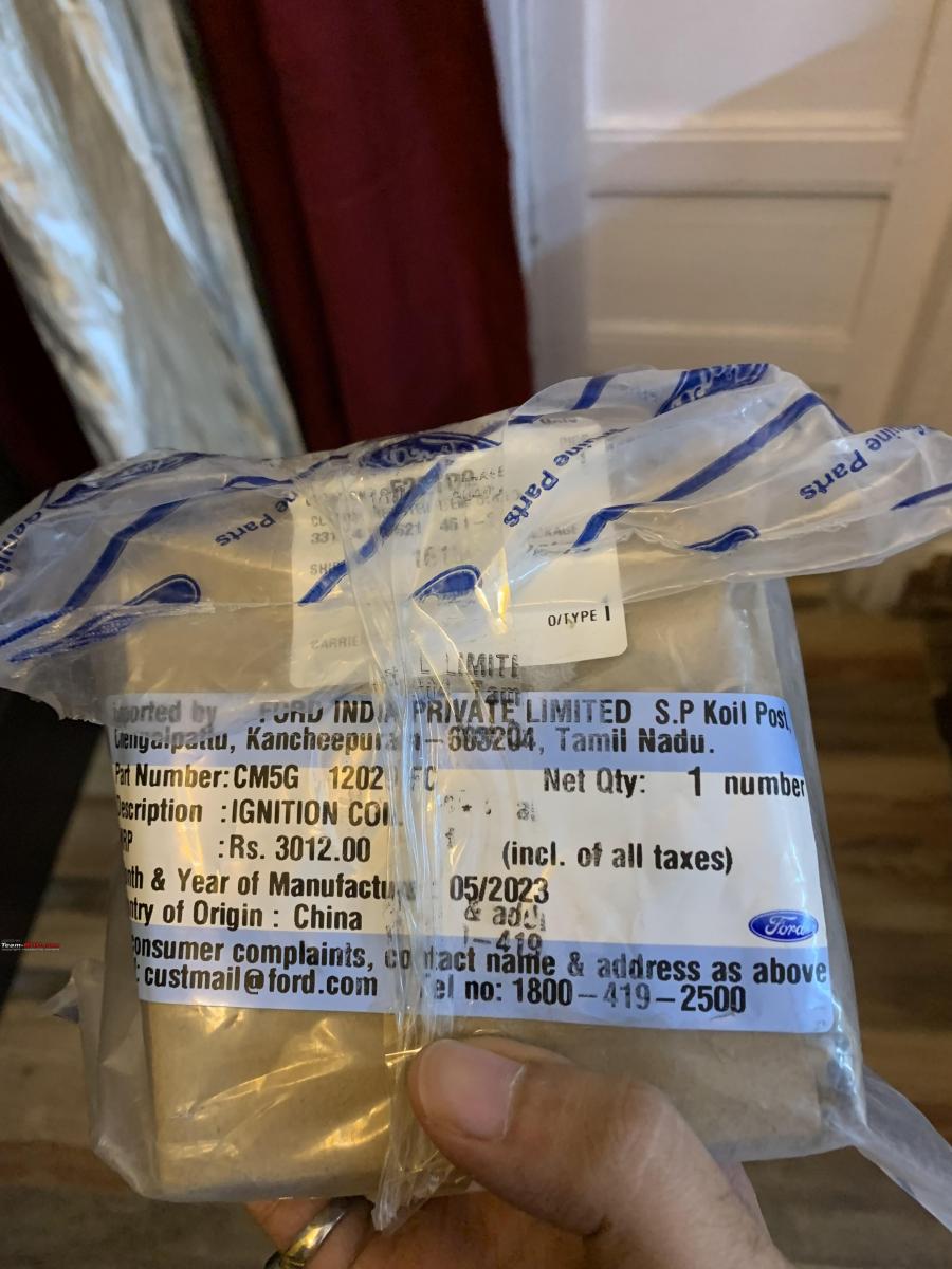

However, some research on Boodmo told me that the ignition coil for the 4-cylinder 1.5 Ecosport is the exact same part! Immediately placed an order on Boodmo and had my mechanic replace the part at home. While we were at it, also replaced the HT leads. The car is back to its former self, firing on all cylinders!

The defective part:
New original Ford part from Boodmo:
