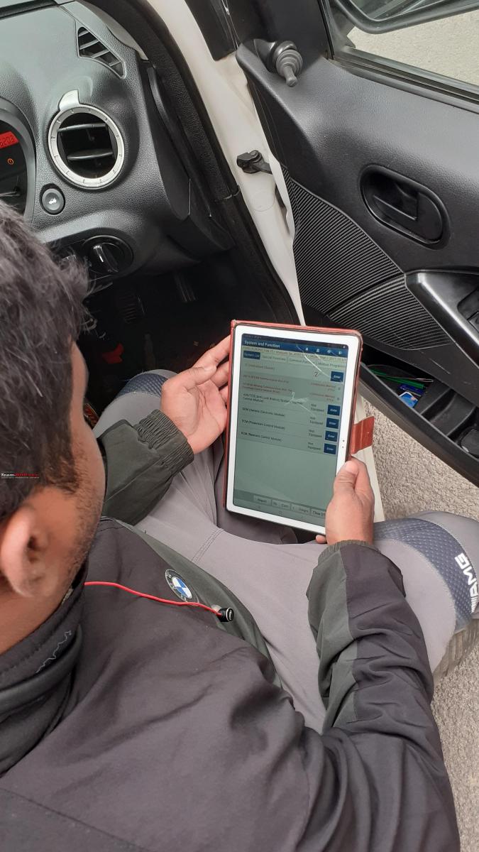

Next day morning, I reached there by 10am with the spare key. They did something and asked me to go for a test ride and handed over the car to me. I was near Banashankari bus stand and when the car went on a road hump, it stalled and the car refused to start after that. Was getting the engine lock symbol(immobilizer) alert. Called AC shop guys and they asked me to disconnect the battery and connect and try again. Did everything and nothing worked. Then they gave a couple of car scanner contacts and one guy agreed to attend. He came and reprogrammed the key. By the time I reached home, it was 3pm.

  • 3k - key reprogramming ( I am assuming, key got decoded during dashboard removal and fitting process. As till then keys were perfectly working fine).
