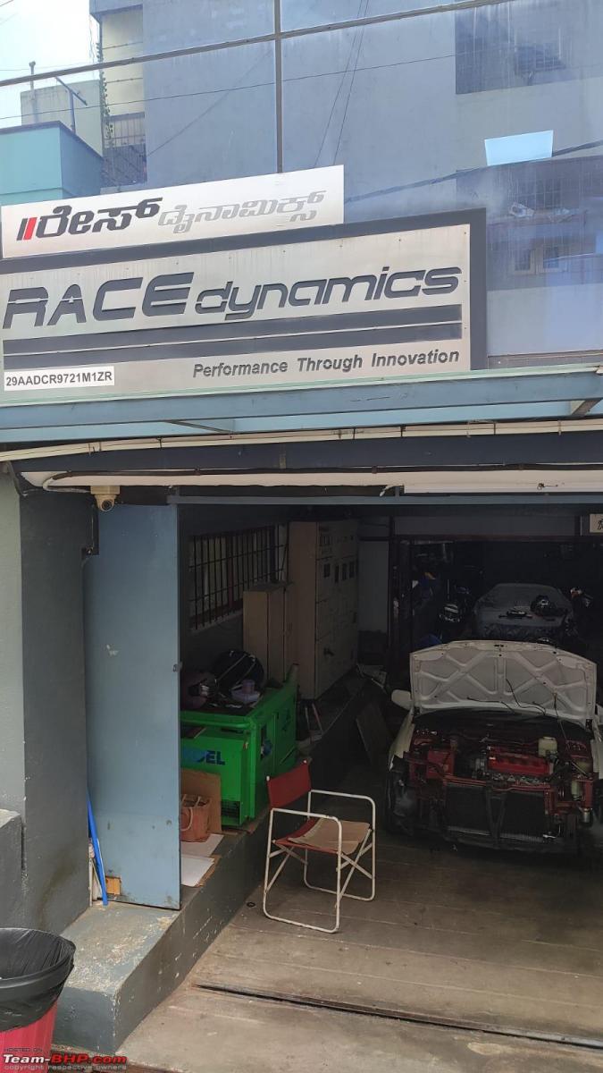

After some Burnol and silver nitride, my next stop was Race Dynamics in Koramangala for the Fuel X install. I bought this as a used product at half price from the owner, the product is still under warranty and I preferred getting the product installed at Race Dynamics to ensure that I'm not buying a lemon. The installation was done in less than 30 minutes and the installation cost was 900 bucks - a little steep if you ask me but peace of mind is priceless right? I now have the invoice of purchase, a valid warranty, and an invoice for the installation at RD. Dealt with Jawaad and Sommaiah and the experience was pleasant.
