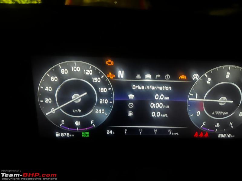

My colleague reported this at start of the week and dealership did some update and cleaned but this came back today again. They have called the car again on Monday to check thoroughly. They plan to replace the DPF filter after doing some more checks.
He drives mostly on highways, so don't understand why will this need replacement ? Anything to do with fuel?
Meanwhile here's what BHPian Bibendum90949 had to say in this matter:
I had owned a Seltos for 3 years and 30k kms. In my experience and of the others in the Seltos group, Shell diesel in Seltos tend to give DPF trouble, may be owing to the additives they use. Most of us switched to IOCL or BPCL back then. I could see some of them mentioning Shell at the start of this thread too.
