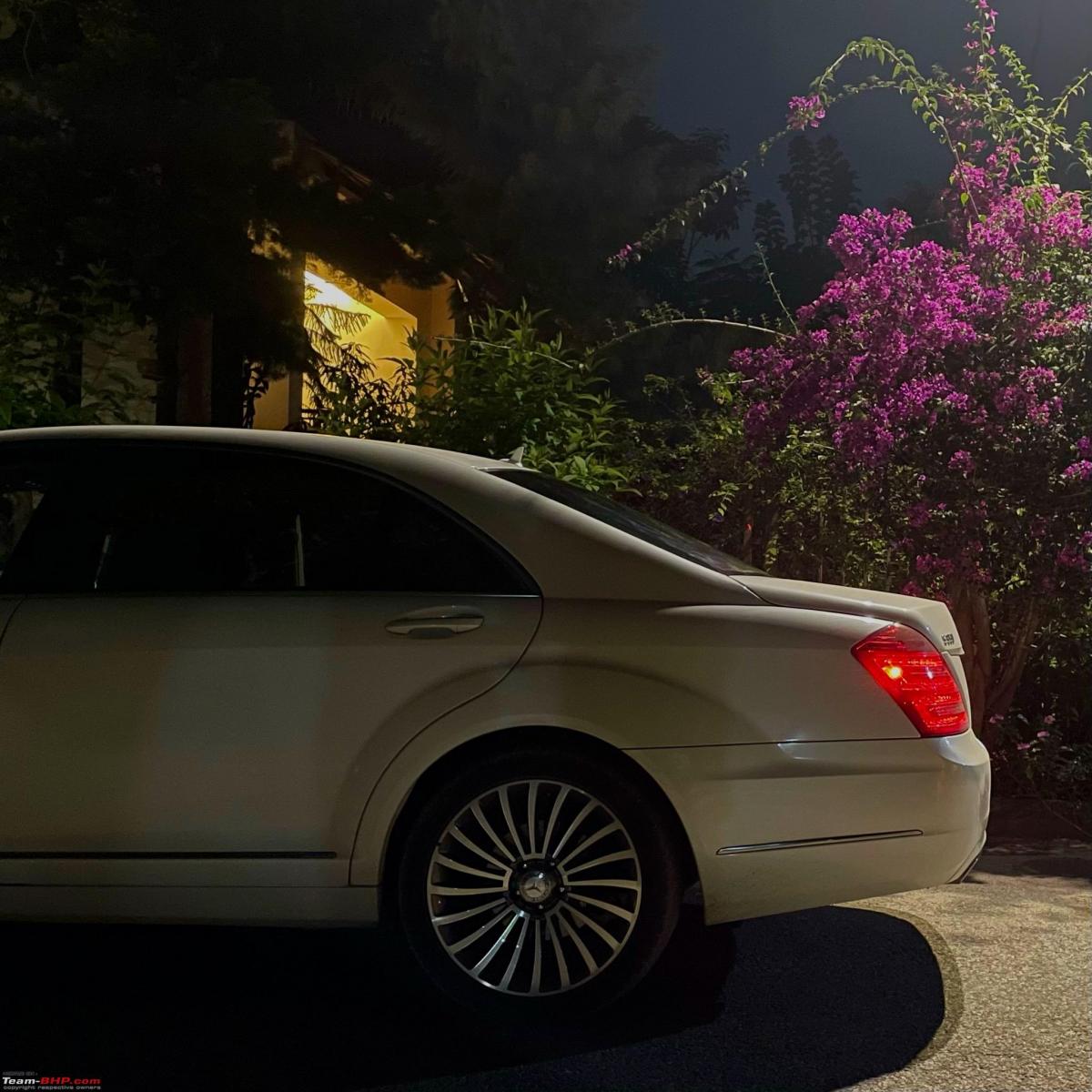

The car is back on duty, on the way to clock 70K km. Not just that, it is seeing a lot of daily usage these days due to certain changes that took place. Needless to say, I am hoping for a more economical 2023 :-)
Aging gracefully:
