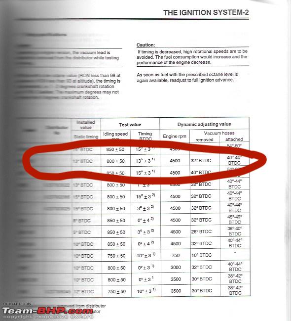

So decided to try a few other things as well. I went through all my W123 manuals again and visited a number of W123 forums around the world. Funnily enough, I get conflicting information with regard to how or even whether you can measure the ignition timing on my W123 with the electronic ignition. Some manuals and people claim you can only do this with the original W123 diagnostic equipment. My W123 friend Cor has it, but I did not want to bother him again.
So I had a go with my generic diagnostic tools. The thing I wanted to verify was the amount of static timing. According to my manual and also there is a little specification plate mounted under the bonnet, saying it should be around 13o +/- 3o.
I checked it with two different measurements. I used this old Ford diagnostic tool.
It measures various things, including RPM and the dwell angle. Dwell angle is not the same as static timing. Dwell angle is the angle of rotation that the ignition contacts are closed. Static timing is the angle at which the contacts close. But as this is an electronic ignition you can’t measure dwell with this tool. However, from what I can figure out it will actually measure static timing!
I also verified this with my strobe tool. Point it at the front pulley and read the number of degrees!
Sure enough both tools gave me the same value! Around 13o. I experimented with a bit more and a bit less. Took it for test drives. Ultimately I found at 15o the engine runs almost perfectly, let's say 99,7%. Good enough for now.
One thing though, you do need to disconnect the vacuum advance on the distributor. Initially, I had not bothered as I thought it would not make a big difference at idle. But it did, almost 3-4o!
