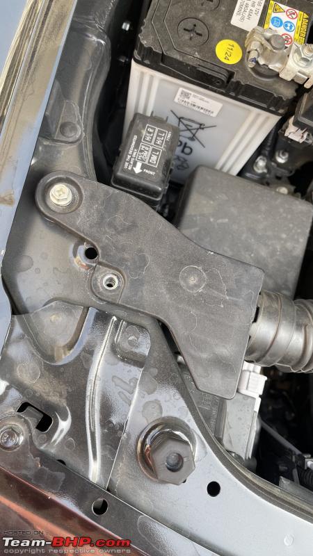

Now, there is still 1 place where rats can get to and destroy vital components: the air filter. I experienced this with my Figo and was unwilling to take any chance.
  • Open the Hood.
  • On the driver's side, to the front of the car, you will find the air intake hole for the engine. Unscrew those bolts.
  • Size the metal mesh appropriately and secure it in place. I used 3M tape and a zip tie. I will suggest against using any screws or adhesives.
