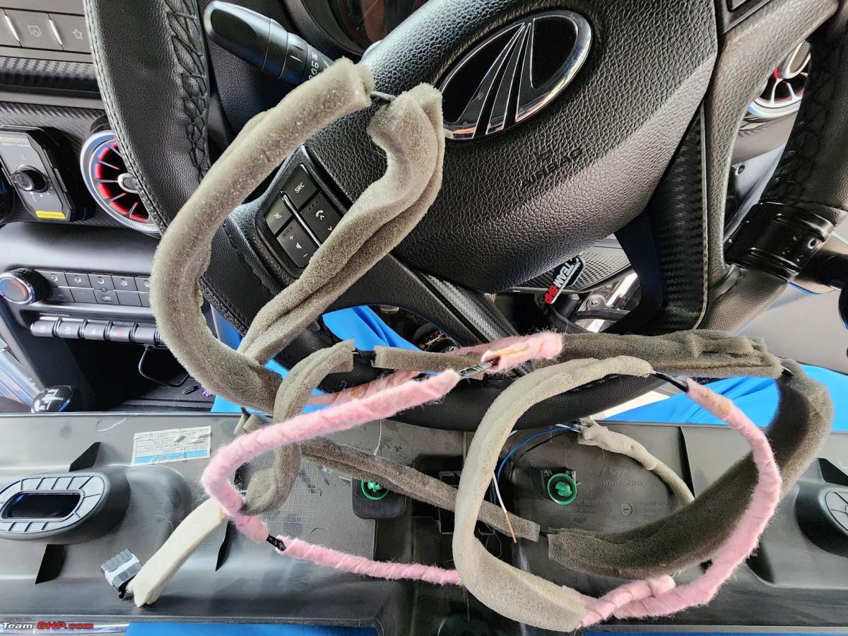

Day 2 - Worked on the wiring! Made the mistake of forgetting to RTFM. The green wire from the harness goes to the +ve 12V (ACC is a good fuse to tap) and the red is for reverse +12V (pointless when you have a reverse camera on the stereo). Who'd have thought? Black is ground, thankfully. After hours of multimeter testing, I went back to reading Shashi's thread HERE. He's been a TBHP-gem-of-a-person through my K12 2010 Swift ZXI ownership and a trove of knowledge (and spare part guide!)
Day 3 - It's been raining so I waited a couple of days before I got started on loading the windshield mount. The urethane is still somewhat gel-like so I am not going to put the car through the paces anytime soon. The focus today was to get the mirror connected and done with. And it worked out just fine.
