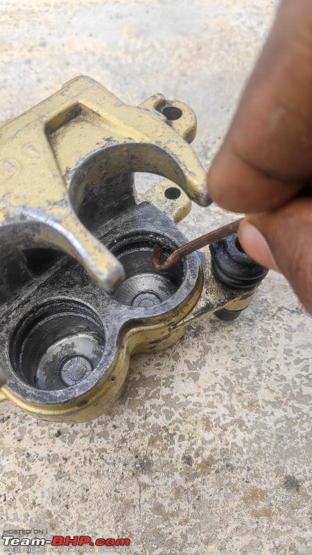

Then we turned our attention to the front brake caliper. The pistons were seized and were locked in too tight to be pulled out by caliper pliers. I followed a trick from a YouTube video, putting in small wrench sockets into the piston and using the Allen key to turn the piston and take it out. Even with such high leverage with the Allen key, it was extremely difficult to take the piston out because the seals were completely damaged.
Piston caliper removal
The dust seals in the caliper were eroded by salt water which was to be expected considering that the bike was written in Chennai there by increasing the possibility of exposure to seaside air.
Even after removing the seals, the insides of the caliper were full of oil mixed with dirt and pieces of rubber.
The rear caliper was in exactly the same state so after taking that piston out as well, I replaced the piston seals. The rear caliper dust seal on the other hand were equal if not worse in terms of availability to the crank access cover. However, since the old one was not actually damaged or eroded, I just made do with the old seal.
