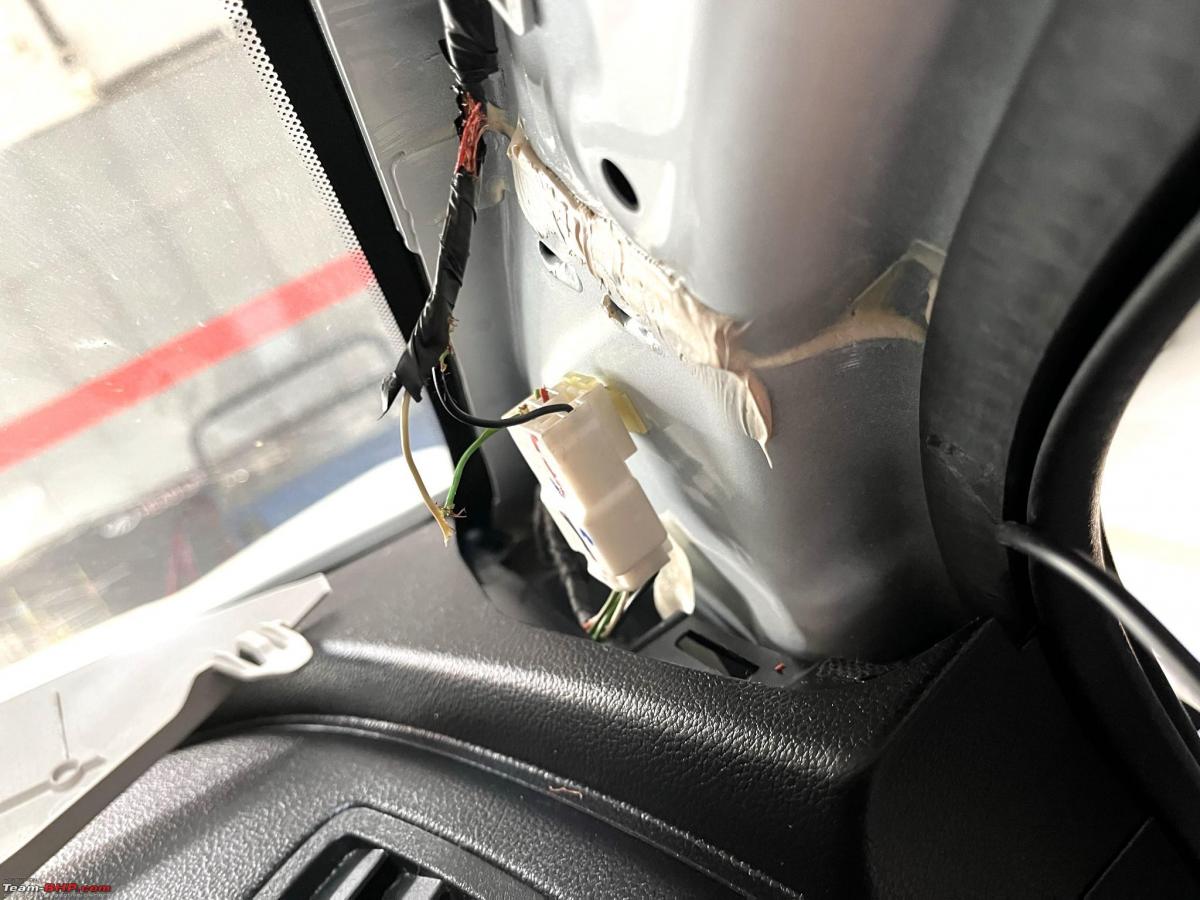

Driver Side A-Pillar Wiring Chewed

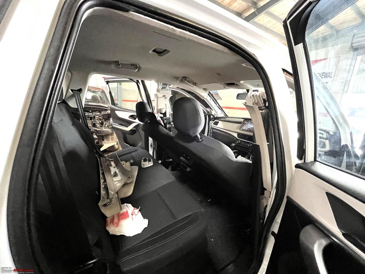

Service Centre dude removing all the grab handles, Sunshades, Cabin roof lights
Notice the dismantled Removed A-Pillars, B-Pillars Panels

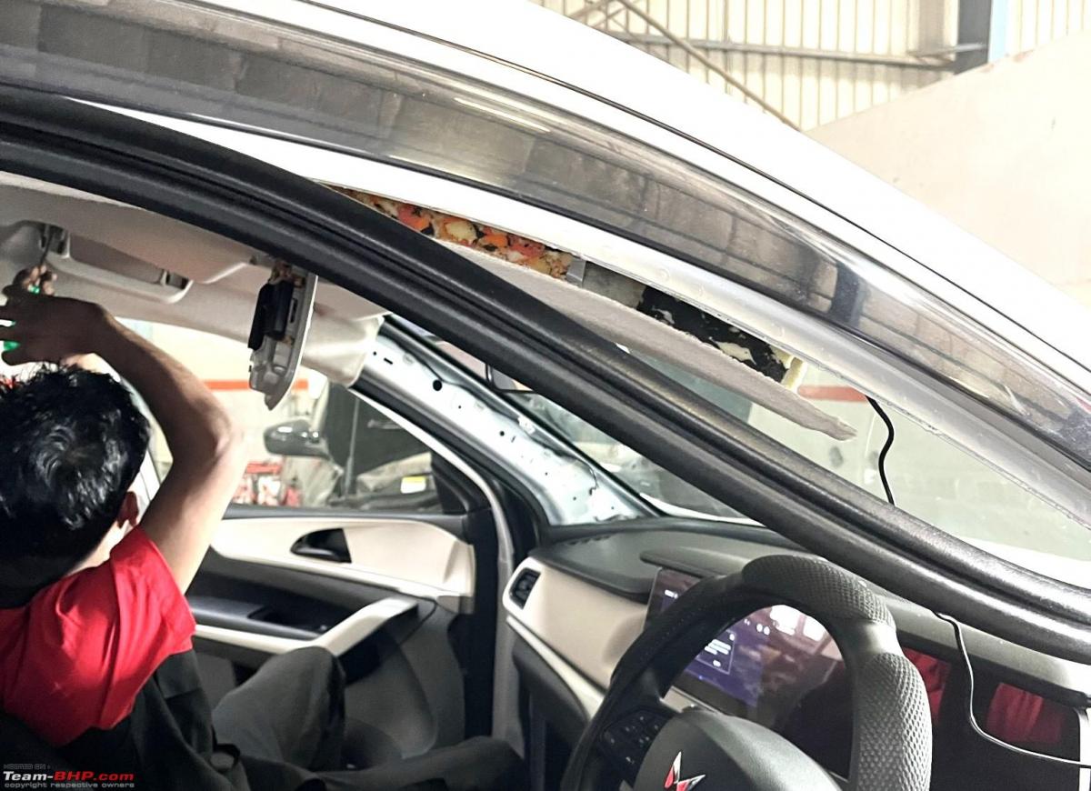

The technician had to jump inside the roof liner to remove the chewed insulation debris
Some chewed insulation debris
During the repair of the wiring, it was found that the rat moved through the A-Pillars to the roof liner and also chewed away the insulation/ padding inside the roof liner. I never eat/ drink/ store/ litter food in my car. Actually, nowadays, manufacturers have shifted to Soy-based insulation in cars for environment friendly reasons, but it can also attract hungry vermin. Didn’t they find any other goddamn substance on earth that is less seductive to rats?
Overall, it cost ₹ 8000 and 3 visits to the service center to repair the damages done by these over-curious creatures.
