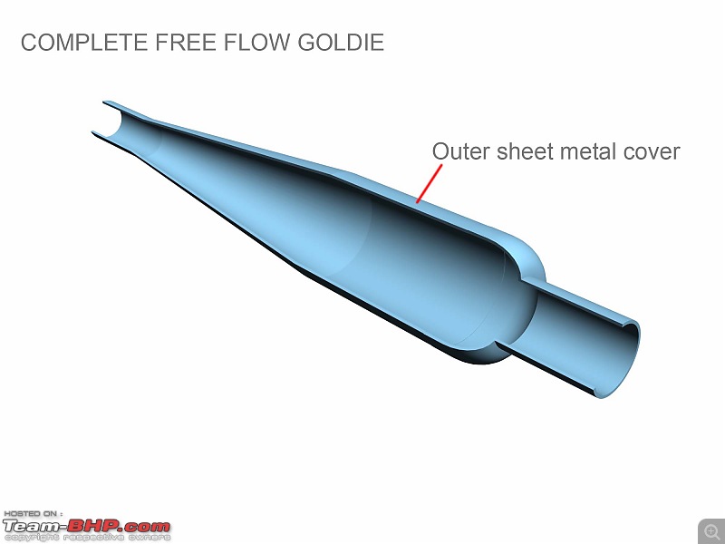

My understanding of the types of goldie available is as follows:

Very nice explanation. Thank you. So a goldie with a conical baffle is not completely free flow. I thought that since it doesn't have any wool inside it would let exhaust gases flow without hindrance.

I guess compared to OEM pipe, all the varients of Goldie would be free flow.
But compared between them, glass wool type would be more restrictive then conical baffle, or so it appears. mostly we opt for goldie to get a good thump, ( unless someone is in to tracks), and for a good thump, the glass wool is suppose to be best, as the wool absorbs high frequency sound/vibrations, releasing only the low frequency ones resulting in meaty and clean thump.
Things to keep in mid are the diameter of the inner perforated tube and diameter of rear cap, with respect to whether it will be mounted on the 350 or 500 cc. Also, whats to be kept in mind is the amount of glass wool thats filled.
Different small workshops/compnays makes these silencers in various parts of india, but they differ from each other as the above mentioned diameter of the inner tube, outer tube and its angular gradient, end cap diameter, wool quantity and length of pipe.
Not sure if anyone is able to crack the above and get a standard values for 350 and 500 varient.
Ok i am a little confused here. As far as i remember my silencer is like the one shown in pic 1 except it does not have the perforated tube. I think mine has a tube but it is a solid tube and not with perforations. Still i will check to confirm.
Has to be perforated or else the galss wool become redundant. Do have a closer look.

Thnx for those pics. as you said all shown are more of free flow types considering the straight-through central passage. OE silencers mostly have the bottle divided into three compartments through which the gas zig-zags. sorry i have no pics. Seems like a transplant/ replicating inner baffle assy from OE is the only option left to get a baffled low-noise goldie.
hi bludhemn
yes,its true that Goldy with conical baffles is not completely free flow.
The Long perforated tubes itself act as hindrances.
Also ,its safe for your engine too as its able to create enough back pressure.
sans is offline
