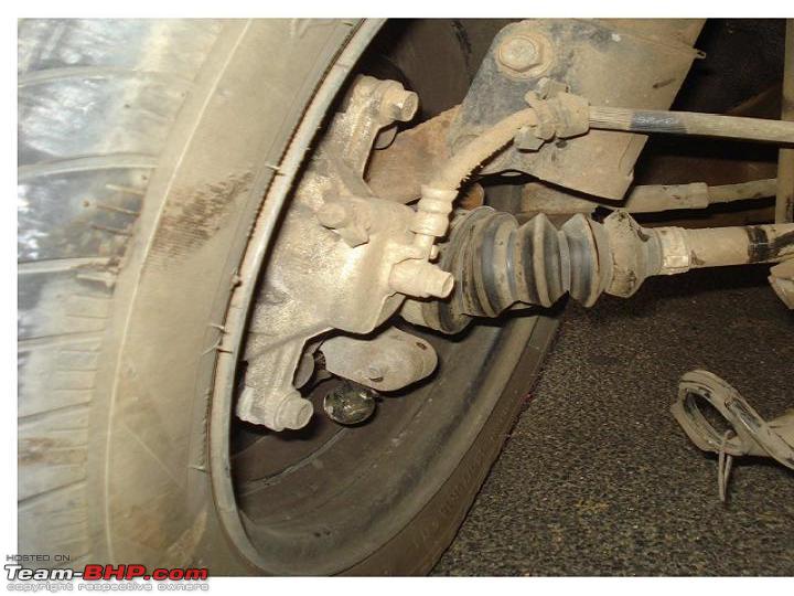

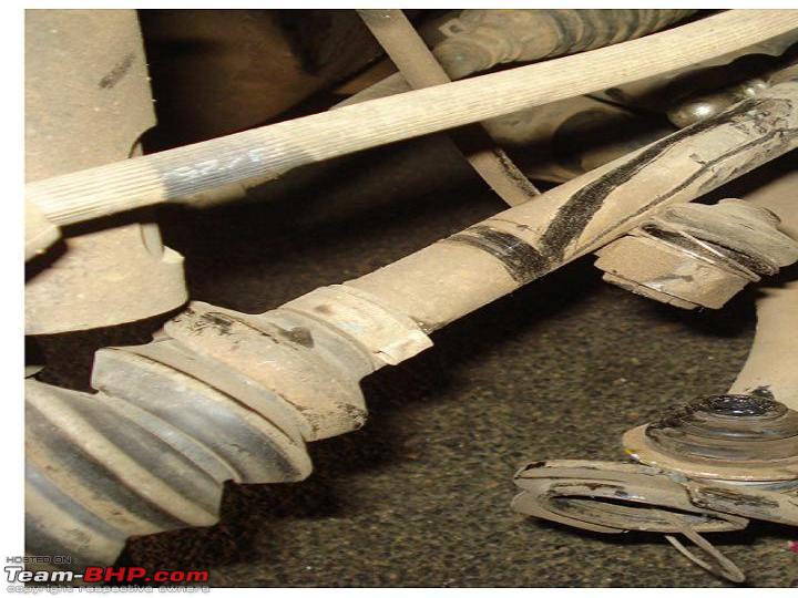

Yes, the repair is set to be claimed under warranty. We have written a strong mail to GM as well. Now the car is waiting at the showroom for the Insurance surveyor's visit. Just in case..
I do not know how to paste the pictures here. Attaching as a file. It is the not ball joint that has failed actually.
Yes, its the suspension ball joint (it also acts as steering pivot) that has failed, but this is first time I have seen a ball stud coming out completely. Also, as per the design guidelines of a ball joint, the stud pull out force is much higher that the usual loads experienced during driving.
I may assume the root cause of this failure is the rubber boot cut and consequently the ingress of dirt and slush in the ball joint resulted in wear. But failure of this extent was not at all imagined/ considered by me in past.
Had you or your friend noticed any noise or wobble from this wheel prior to the failure. As this kind of failure is ought to give a indication in terms of handling, noise etc.
Also, I could notice the Lower Control Arm bent, is this the normal shape or has it bent due to failure ? I should check on my Beat.

No. He never experienced any sound / handling issues prior to this accident. I was also driving this car occasionally, hence I can confirm there was no indication for this kind of failure, not even a slight noise or rattle.
The arm bent is due to the impact during the accident. Not original design.

Lower arm ball joint is cut, rather popped out! Man this is serious, good that you have documented with pictures. Try to escalate and get it covered under warranty itself.
