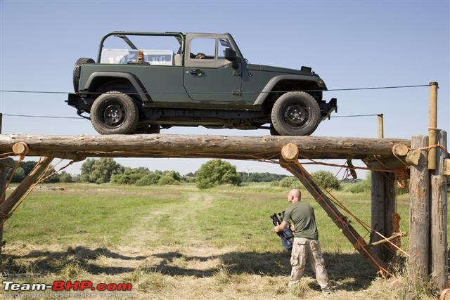

Next question(s): why do you think a different track-width is bad ? What problems does it cause ? Why do you want to make it equal ?
so in general highway driving the 2 inch track difference will not cause any problems.
but when a jeeps try to cross ditch or small river stream on tree logs the 2 inch track difference is not Ideal.
