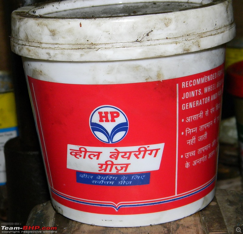

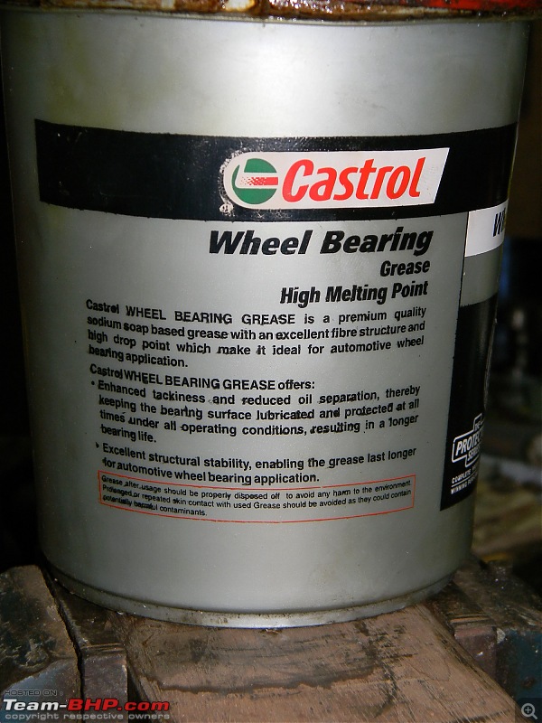

Two types of grease is used
# 1 the Wheel Bearing grease particularly for the U Joint (U J ) cross bearings
UJ cross bearings work under extereme load conditions & work in different angles , so they need a very heavy duty grease
# 2 the Chassis Grease for slider portion
The slider portion also needs quality grease but can go with some lighter type of grease , however I will recommend a thick grease for old sliders .
Heavy Duty castrol grease for UJ cross bearings

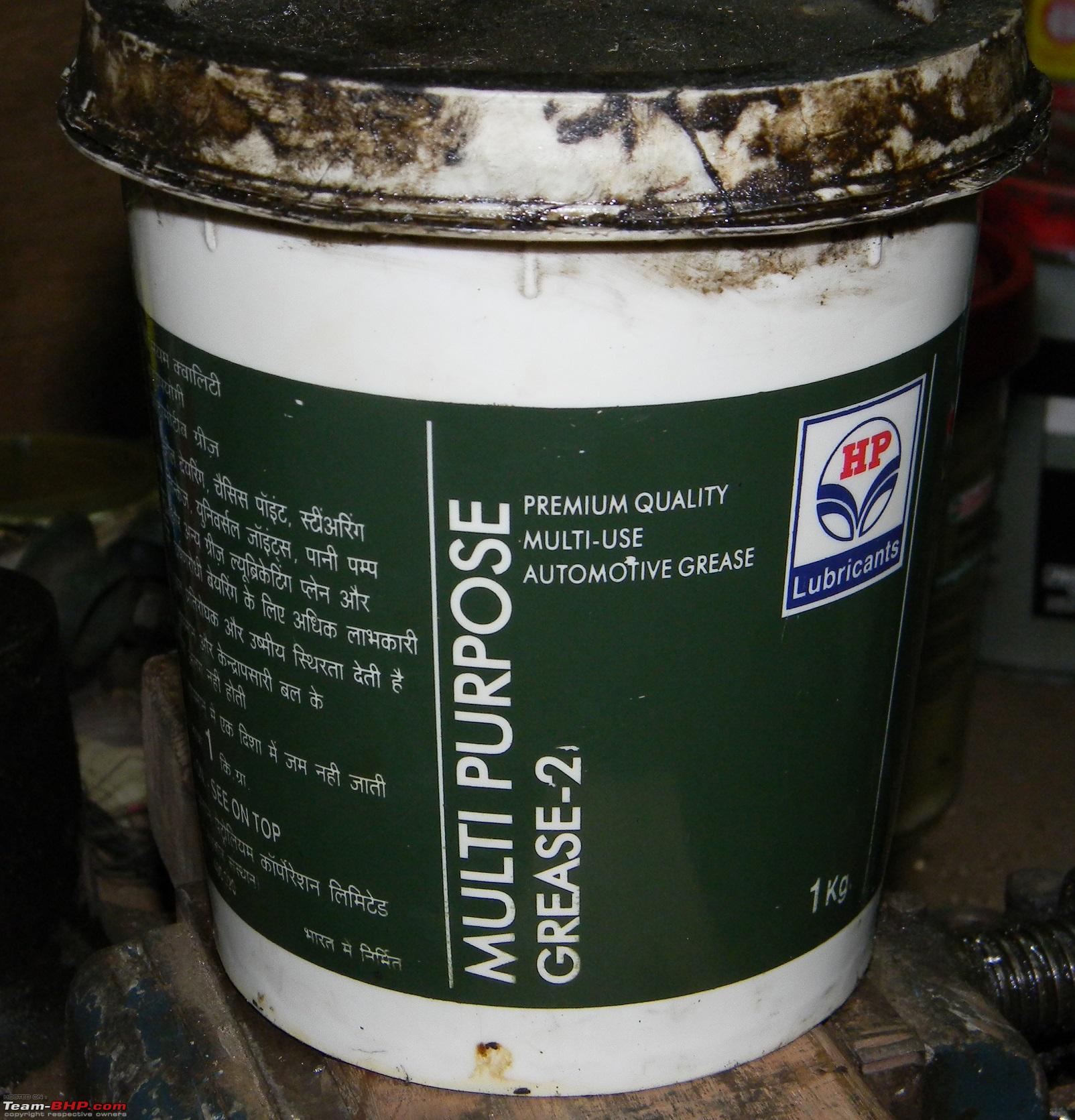

#Other available from the H P

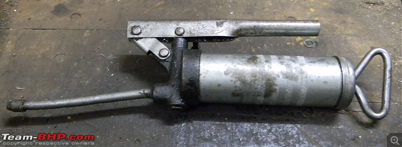

#2)Keep your own small grease gun , filled with wheel bearing grease , especially for propeller shaft greasing points --- those will last for years if you do them for every 1 k km , in toughest conditions
#3)if you are really interested / capable in doing it , keep two of them --- but remember wheel bearing grease is for the prop shaft cross bearings mainly / only .
# second grease gun goes with a thinner water resistant grease for all those leaf spring points & steering linkages .
Hand Held Grease Guns For DIY
These hold some 200 Gms of grease , can be kept in tool kit & used at service ramps at your own will .

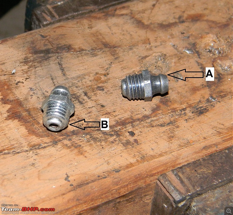

Something to add to.
If any one wants to do the grease the DIY way , here is a tip
# remove the original grease nipples & take them as samples to the Jeep parts shop
# buy spare grease nipples , exactly matching the sample [threading particularly shown B in the pic].
# This will help you in greasing when a particular nipple is jammed or damaged. Simply remove the damaged [this portion A in the pic]/ jammed nipple, replace with spare & continue .Re fit the original after greasing if you want to
# Spanners needed will be 6,7,8,9 or 10,11 mm max

Grease nipples are rarely found in automobile spare parts shop. May be because the Jeep is a dying brand!
They are plenty and in a INDUSTRIAL SUPPLY shop. I guess heavy machinery uses them! I picked up around 10 the time i realized they are not a regular spare part. Costs about 2Rs each.

Adding a pic of a larger grease gun, which I also use. This one has a handle to pump grease. But this is a cheap local copy of some good " English " design .
I use this mainly to pump grease & oil mixture in the Jeep's & Land Rover's front closed knuckle, where two very vital parts get lubricated . One is the King Pin bearings & second is the Universal joint on the front live axle . This is also a neglected area.
# Caution , over lubrication of the front closed knuckle has its own perils.
Here to share, a larger grease gun (mostly used by the " Line " truckers)

You get smaller lever type grease guns also. The push type don't work well.

Totally Disagree SIR , they do work well
Anyways, after my first bike came in 85 (Yezdi 250), my good friend's father gifted me one of such smaller grease gun, actually he was quite amused with my chidish efforts in " Maintaining " the bike " properly". Then came the Jeep in 89 & I bought another & started using it.
Moral of the story; using these since then & also tried my hand on the other types with few friendly mech's courtesy. So I found them quite convenient.
# These are smaller in size to be carried with the vehicle, it doubles as a storage of grease in case of need en route .
# These contain very less amount of grease , so wastage gets controlled & one gets proper track of consumption (my pockets were always less filled)
# Another feature is these do not have a spring " preload " on plunger, so oil from the grease does not drip in storage (Kit). It happens in handle walla type
Note ; most of the time jammed nipples or bushings/parts need excess pressure, but if done regularly one just needs few strokes & the grease erupts from the other side.
