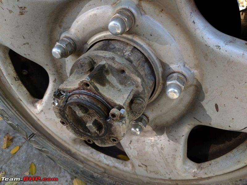

I'm guessing they wouldn't cover physical damage; Well, I was out of the warranty period anyway:
Still functions but looks bad (couldn't find the piece that broke off or I'd just re-fit it) and I suppose it'll be more prone to water entry. This had always been my one objection to these vs. the fixed flanges - they protrude out too far, widening the vehicle by a couple inches per side. Admittedly driver error, but I hit this one at maybe 20kmph on a support on a narrow bridge. Could happen on any rocky trail too, I suppose.
I wonder whether the slight bit of extra diesel consumed in turning all the front axle mechanicals - along with all the work I'd have to do related to making sure all my cross-joints were tight enough and my front drive shaft true and well-balanced (none of which is the case presently) - would cost me more or less than a new hub...
The appeal of cheap, durable, simple and non-protruding fixed flanges is increasing. In truth would be nice to not have to get out and lock these every time I needed 4x4, too.
On the flip side, there have been a few times when 2WD low came in handy, a service these hubs can provide. For those running the two-lever Dana/Spicer transfer case, a very small mod can get you 2WD Low, too, in which case the hubs would be redundant (our Marshal's been refitted with the Borg-Warner case though).
-Eric
