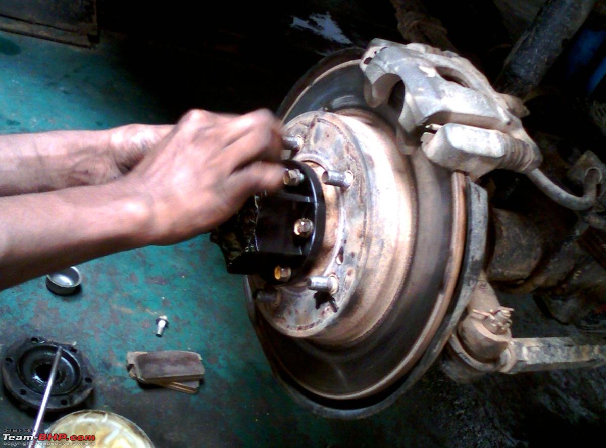

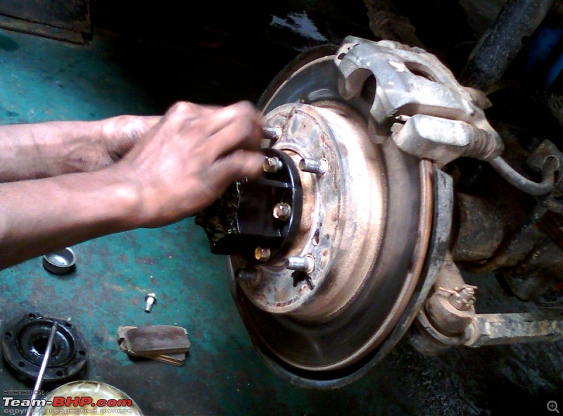

I got the free wheeeling hubs installed today on the Gypsy. I wonder why I took so long to get them done. The drive for sure is a lot better in 2WD on road with these FWH's and goodbye to the 'hum hum' of front drive train in 2WD.
A very very simple DIY but got it done at Suraksha. Here are the pictures

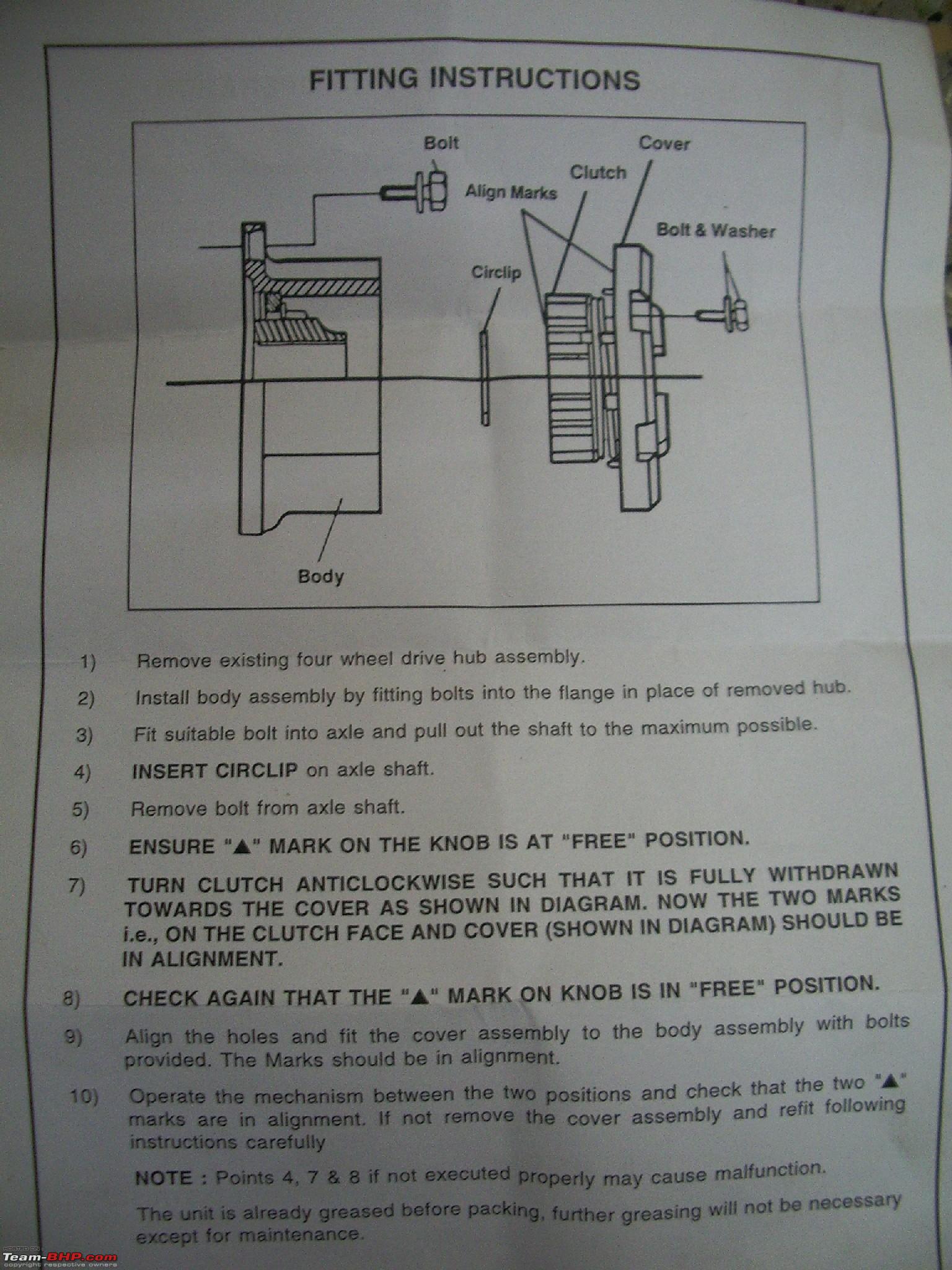

Dear Uday Bhan Singhji and Others
These are the 3 pages I got. Does mention on page 3 about periodic checking.
