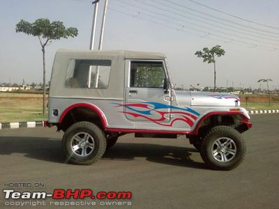

hi.
Yes it has hydro suspension not pneumatic. you are right pneumatic suspension is much different from hydro.
i use industrial hydraulic shocks made many modifications ,and i made 3 accumulators to observe shocks (2 for front 1 for Rear). it has custom made electric controled hydraulic pump run by its toyota 3.0lt turbo charged engine.. it has total suspension lift of 0" to 13".. i am going to start new thread with complete detail and pictures.
