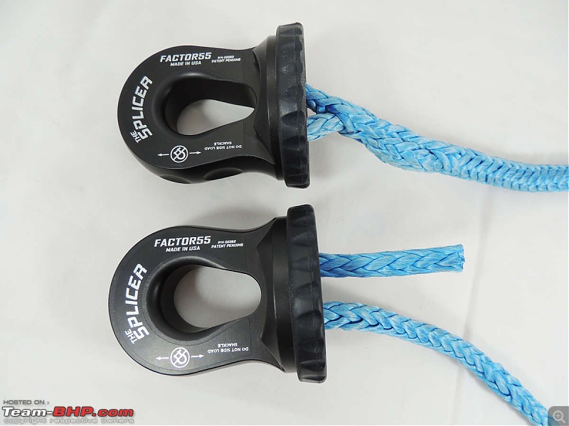

Winch hook replacement!
Winch hook replacement! (For synthetic winch lines)
Came across this piece of nifty engineering while browsing, so thought of sharing.
I felt the option is good, if the winch hook makes a clack when you hit a bumpy stretch. Or say, if the mental scratches (as if that matters while off-roading) the bumper of the ride you are trying to winch out.
The real thing being, instead of metal hooks and synthetic line, this hook is real neat. But they do say one needs synthetic rope splicing expertise to hook one up.
- Rope protection
Source

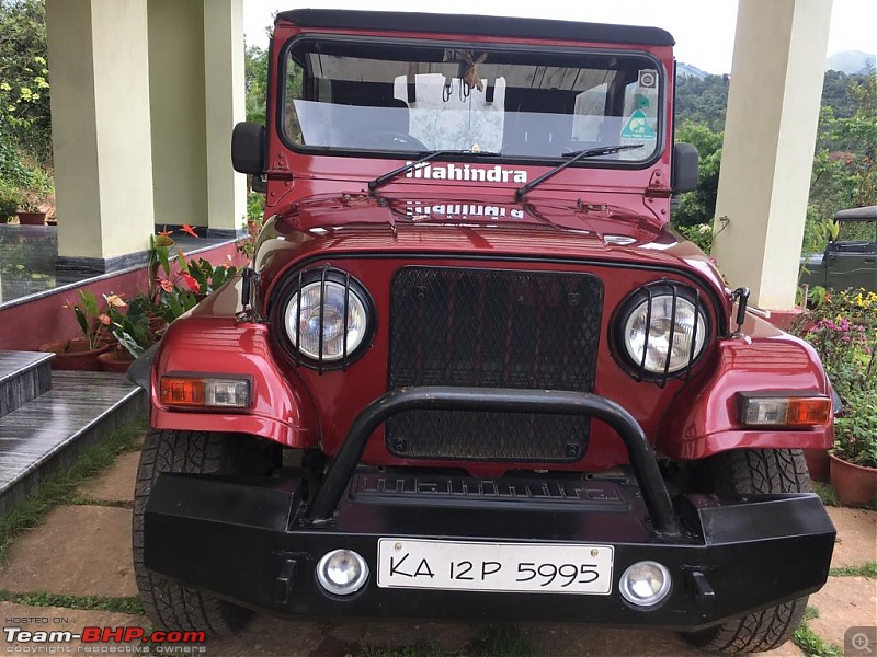

Hello ppl! I would like your expert opinion on procuring the best winch for my Thar. Any advice would be highly appreciated.
I went through different posts in the forum. However, most of the posts are few years old.
While researching, I came across the following brands (few from this thread/forum):
- Ramsey (read some good recommendations in this forum)
- Warn (seems to be the forum fav)
- Smittybilt (I’m inclined to these as they offer waterproof winches)
- Superwich
Some pointers:
1) I am not interested in opting for the synthetic ropes - maintenance / higher cost, although has few advantages - safer, lighter etc.
2) I’m thinking of choosing between 8000-10,000 lbs - not more, unless closesly priced.
3) Im inclined towards water proof winches.
4) I’m currently located in Europe, so any German brand would be easy to procure. If not, I’m considering buying from Amazon US (I have few questions related to this - import costs - I’ll hold on to those questions until I finalise the brand/model).
5) any Indian alternatives?
6) budget is within ₹1 lk including shipping, import charges and winch cost.
Below is the pic of my 2012 Thar. Waiting for it’s midlife upgrade. First of it was the bumper. Many more to follow.
Hi,
Why to take so much headache. You get good Warn winches in India at comparable price (65K). For occasional use Mile Marker is a good option to (in 50 K INR).
Shubhendra
Shubhendra is offline   (1) Thanks
Old 13th November 2018, 15:24   #191
Tejas@perioimpl's Avatar
Join Date: Sep 2008
Posts: 4,430
Thanked: 9,764 Times
Re: How to get a top quality winch?
- Superwich
Some pointers:
My 2cents:
-get synthetic rope. If you are a newbie to winching, it's safer for you though a newbie can wear off a synthetic rope faster than metal. However, safety wise synthetic stores much less KE.
plus less weight on the front end
- don't go more than 8k in rating. look at ampere draws on full load when selecting a winch. high capacity winches would draw upwards for 500amps on a full load and your alternator just would run not cope up. I'm assuming it's a recreational winch and I would go as low as possible in the load rating and invest in a couple of snatch blocks. Double up the power without draining the battery and overworking the alternator
- Germany is nearly the same cost for winch as India. If you buying from US, only then would you save money. And If you are getting from the states, every i4wdta trainer worth his salt is recommending the super winch as currently the top brand in terms of reliability. Second option would be smittybilt.
Last edited by Tejas@perioimpl : 13th November 2018 at 15:26. Reason: corrected typos

Thanks Shubhendra!
Oh! thats great! I only searched on Amazon, and it gave me this message: "Your cart subtotal exceeds the maximum allowed limit for imported items in a single order. Please edit your order to take cart value to less than Rs.50,000 to proceed further. "
Any idea where to procure in Bengaluru?
Originally Posted by Tejas@perioimpl View Post
My 2cents:
-get synthetic rope. If you ...
...option would be smittybilt.
Thanks Tejas! ok, will consider synthetic as an option too and will stick to 8000lbs. I hadn't thought of the load on the alternator/battery.
I also didn't know that a snatch block doubles the power, although had watched some vidoes about it!x2
Ok, will drop the idea of gettting it from Europe. I thought of asking my friend to get it from the states, but then its quite heavy, possible customs to be paid in Bengaluru, so decided against it to avoid all these hassels. So, yeah, anyone knows where I could buy in Bengaluru?
