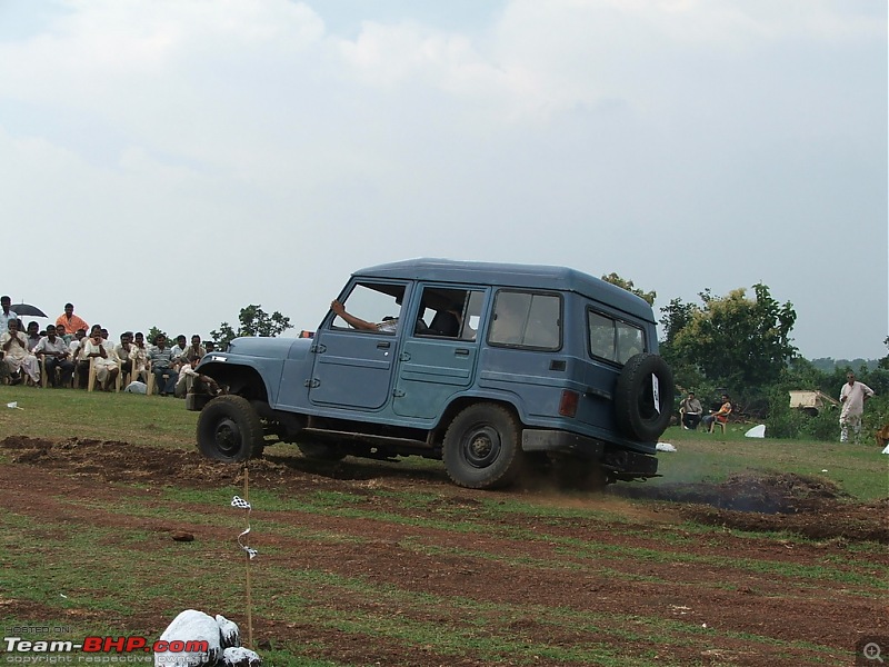

To illustrate, here is a scenario (from Hyd OTR report):
Gypsy on Steroids: Next Dose -- Short Chassis for reduced rear overhang-img_0085.jpg
With the rear overhang of the LWB Gypsy, the chances of rear scraping or bottoming out are much higher. The reduction of rear overhang will also help in acute turns in some rocky inclines/paths that I have encountered in some OTR's (especially Thipagondahalli)

just for your information from what I observed at the above mentioned event:
The jeeps in stock condition cleared those obstacles with out bottoming. Even in the above pic, its a short wheelbase model but its not in stock condition and yes it bottomed out.
There was a mahindra comander hardtop long wheel base. its in complete stock condition, it cleared the obstacles with out bottoming it out. BTW, there were 5 adult men(one of them a hefty guy) and 4 children in the comander, it finished course with ease. I repeat with ease.
I will post the pics by tonight in this thread and also in the thread dedicated for the event.

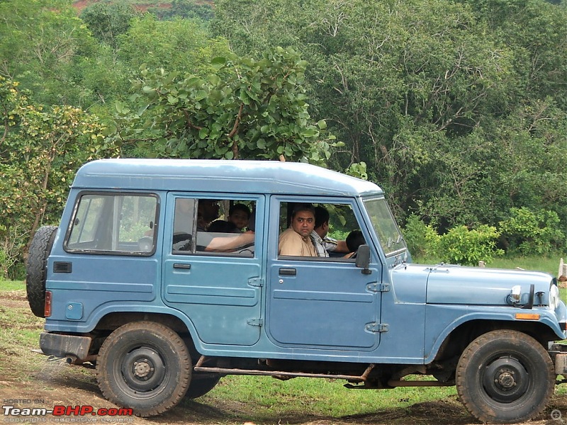

though these pics maight be OT, I just want to highlight the long wheel base comander:
Gypsy on Steroids: Next Dose -- Short Chassis for reduced rear overhang-dscf6028.jpg
