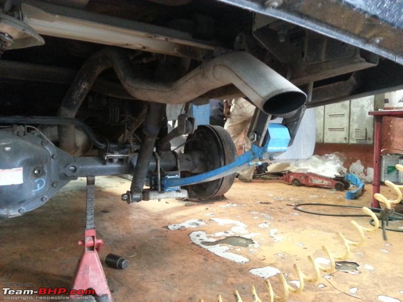

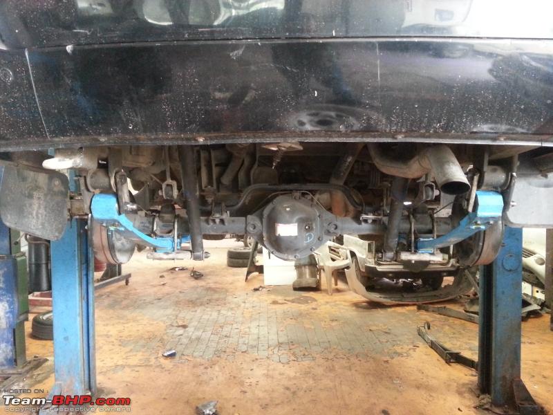

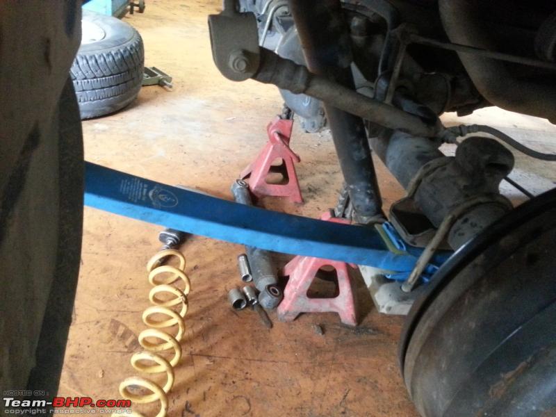

I have done around 100 kms (on the best and worst roads of Delhi) with the CFLs on, here is my feed back.
- The height of the car from the rear has raised a little.
- The ride has become much more 'springy', more bumpy.
- Even on smooth tarmac like the DND expressway, I kept getting unsettled on the driving seat. More than ever before.
- On the stock springs, where I would get one mild bump, on CFLs now I get two shorter mild bumps. I literally feel I am sitting on a huge spring.
- The up and down shake has increased. The left to right shake has been amplified by a huge margin, even on slight undulations on the road (Even on roads like DND, Greater Noida Expressway).
- While driving over an speed-breaker in slow speed, I get somewhat a push on my lower back when the rear wheels drive over it. This wasn't there earlier.
Now, my requirement was a smoother ride. And it has gone worse.
I haven't spoken to Doctor Pawar about it yet. Wanted to drive a little and try hard to find the difference. I have sent the pictures of the installation to him, to see if it was done correctly. Waiting for him to reply, will see then what can be done.
Attaching a few pictures below, if fellow members can find out something amiss.

Guess your shackles should point the other way around.[8th picture]. This will always cause bumpy unsettled rides.

Geez... It is the wrong size. The correct CFL should have the proper angle at the shackle, like this.

The vehicle is on a lift and the axle is suspended , in that case the spring is stretched and the shackle is angled inwards right ?
