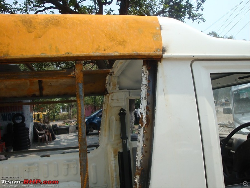

The fabric top and rear flap on my Invader was a problem. I did not have good visibility out the rear through the plastic window. If I opened the rear window all manner of dust and debris was sucked into the interior by the shovel load. In a short 50 meter stretch of trail, the interior and the humans riding inside would be covered with dust. Breathing the stuff was a real health problem. Dust was pulled in the back window opening by the vacuum the peculiar shape of the Invader creates.
I decided to put a hardtop on my Invader. After searching for a long time for a shop to do the work, I settled on a shop in Pathenkot, Punjab. This shop does extensive modifications on staff cars used by Army officers at the big base there.
The side sliding windows are from a Maruti Omni. The rear window is large for visibility and comes from a wrecked Mahindra Commander. This was fitted on top of the original tailgate. A steel door frame had to be added to the rear to shut the new rear door into. I took out the original inside facing rear seats and put in 2 small seats from the Commander facing forward. These leave little leg room but are good for small people and short hops.
I mounted a jerry can and holder on the rear tailgate spare tyre rack and added a heavy bull guard to the front. The interior and seats were done in beige fabric which conceals dust and dirt. The cost was 42,500 rupees and took 24 days to complete. I chose a full hard top instead of a half hard top so as to make resale of this vehicle a bit easier. This configuration is more utilitarian.
The idea here is different from what a "pure" off-roader might do. I am trying to mod this vehicle for use in the Himalayas where I live. I needed protection from the elements, room for extra fuel, gear and luggage for long treks away from home. Previously I put 4:88 crown gears in the differentials. This ratio helps the MDI3200tc motor show its grunt and climb the big hills up here. The extra weight, high on the vehicle, makes a very small impact on performance and handling.

Very good-looking/functional hard-top, DirtyDan, and I like the matt black finish . Hope they did good pre-treatment before painting...there is lot of surface rust on that sheet metal.
Solid tyres, I guess they are BFG-AT? I guess the spare tyre is bolted in place on the floor and not just lying there.
