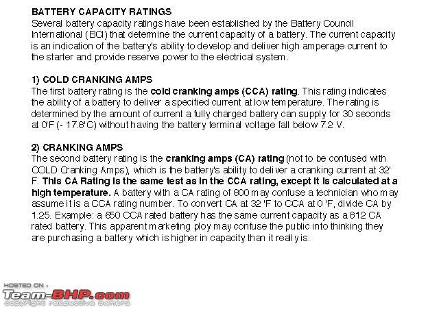

CCA and CA....????
Came across a very good PDF Doc about battery basics when searching for a proper Winch...
Warn says something like "Recommended Battery: 650 CCA minimum for winching"..... So what is the CCA all about?
Amaron Optima Yellow Top: Can they be used for off-roading?-cca.jpg
Read more about battery basics before jumping into buying a winch...
