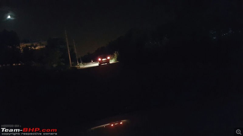

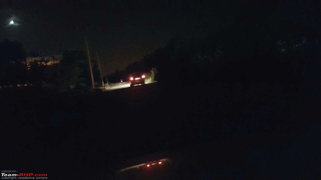

Old 25th June 2015, 15:20   #176
Join Date: Apr 2015
Posts: 45
Thanked: 53 Times
Re: Off-Roading Lights
Mods: Also posted in another thread - Aux Lamps. Feel free to link if it is deemed double post.
Pic 1 - Dark no Lights
Pic 2 - High Beam Stock
Pic 3 - Not in Focus Spots
Pic 4 - Spots focused to ensure it does not blind other people. Zoom to see the volume (Luminosity) of the light. That can be focused to go much much more farther away.
Driving mode in Dark is Pic 4 - so that it ensures ample lighting but not to blind other people. I will post another pic of how far the light can travel when I get the chance to project it on a deserted road. The Driving Mode 4 is not for use in City but while driving in village and country roads.
It is a bit sad to note that stock high beam has quite a bit of scatter in comparison with these spots. This is evident when you can see the building to the left of the picture in Pic 2, but these are not seen while spots are on. This scatter is what causes glare onto oncoming traffic.
PS: I have had these lights for about 2 years now.
