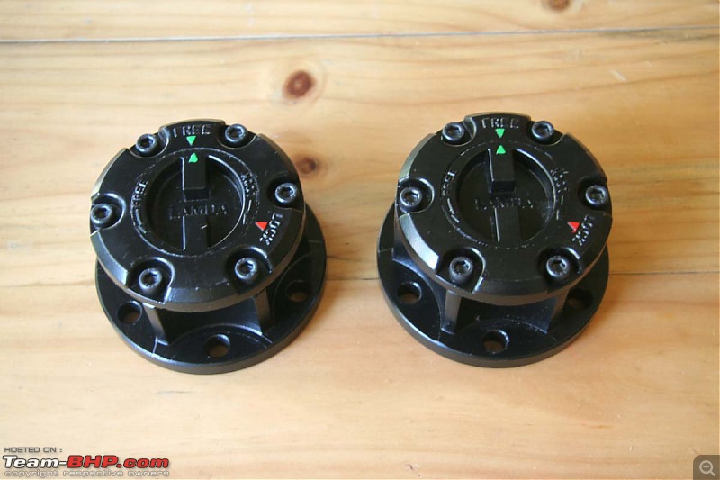

What rims are those? Gypsy? 15"? Do you plan to retain the same or is this just a temporary touch?

I was a bit confused. Long time since I had the Sumo, so didn't recognize the rims. The freewheeling hub confused me even further.

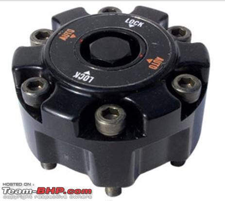

I have never seen a hub like this either. Do you think that the cover from the original Safari hub is missing or did the early Safari have different hubs? This has only permanent lock or auto lock option.
Most likely case would be the hub cover missing. AFAIK, the Safari always came with auto locking hubs and I hardly think the previous user would have changed them to what we see above. Its interesting to see the permanent lock option though. I should check my Safari hubs and see if the hub can come off.

Maybe a box spanner goes in to lock / unlock? Or the locking mechanism been removed and and a bolt has been tightened in to make it 2WD? Castration done to improve "average"

These 31 spline (PCD 90 mm) hubs came with most of the Nissan vehicles (Y60 model specifically). (see attached pic)
It comes with a hex key with which you can set it to always locked (manual) or auto locking.
Hope this helps.

yes these are from the Nissan vehicle. (AFAIK its a warn design)
NISSAN
SAFARI GQ Y60
OEM NUMBER 40250-20J01
SPLINE 31
ALUMINUM ALLOY
AUTOMATIC
31 SPLINES
PCD 90 MM
if they are working keep them, if not get new pair of auto lock hubs .
