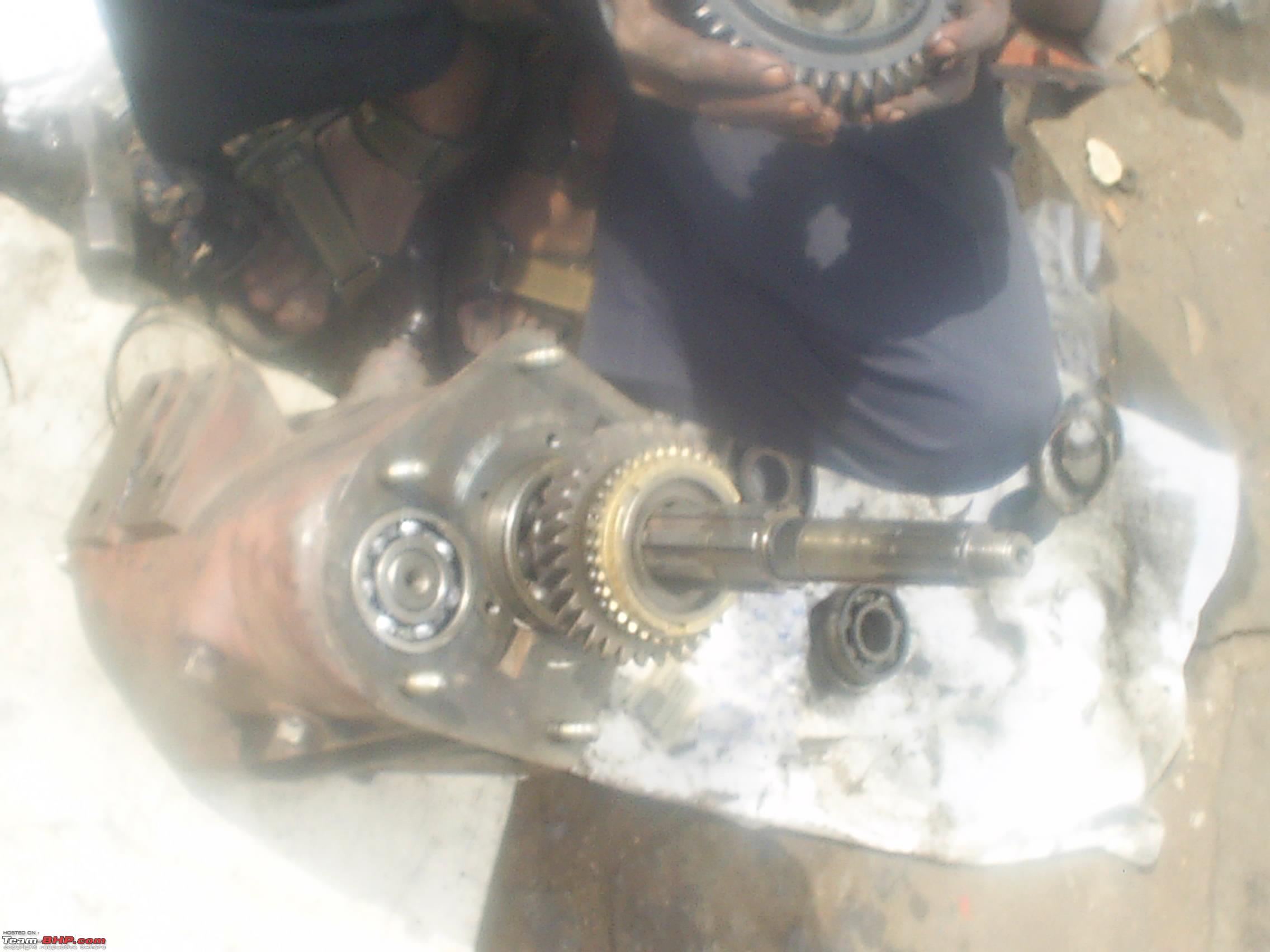

What we noticed was the teeth were intact
good...!!
however, the mech claims that when the gearbox is opened lot of work is involved
He IS a mechanic, right? Hope he is not one of the 'west coast customs' bro' doing a buy it - fit it- finish it job!!
and need to change the entire gammut and not worth the cost involved for repairs and recommended us for replacement of GB in exchange of old one in Gujari.....
So, practically he is giving a clue that his Labor is as high as buying a used GB (which, mind you can be worse than yours current GB).
Sorry to come across frustrated, today morning was spent by me listening to one more of these bufoon mechanics' who was trying to RIP a Jeep owner by saying "Your GB is full of water, yada yada... 10,000Rs"...!!!!
I spend 2.5K MAX (Labor) for a GB+TC overhaul at my mechanics place. Factor in another 4-6 bearings~ at 500 each, 4 liters of GB oil @ 200/Liter, you are still at 6500Rs for a GB overhaul hoping (& most likely always) none of gears are worn out... And - from start to finish it is a 1-day JOB to overhaul a Jeep's GB...!! I cant digest a mechanic who says 'cant repair, lets buy a sooper one from Gujri'. It shows his inclination towards his work!!
Edit - Who is your mechanic? Name & Location please?
Thanks for your inputs Santosh we started our mission on JC Road for repairing GB and found a person by name Babu through our Electrician (Mamu), on meeting and explaining him he just started his job by dis-mantling the GB and provided the list and procured most of the parts from Mahindra authorized dealer, rest were from local market. In total we spent Rs.4500/- and procured all spares for him. He started his job by 10 am am & completed by 3 pm.
This guy seems to be genuine and reliable and know in & out of GB, anyone interested can share his contact.
Here you to :
MM Car Tech, # 37, Behind Mahindra Showroom, Rupena Agrahara, Bommanahalli.
bty am looking for a good mechanic in the vicinity around Koramangala, could not find a good one till date.
'93 MM540 - The adventure begins. EDIT : 4x4 conversion!-s4020830.jpg
'93 MM540 - The adventure begins. EDIT : 4x4 conversion!-s4020831.jpg
'93 MM540 - The adventure begins. EDIT : 4x4 conversion!-s4020832.jpg
