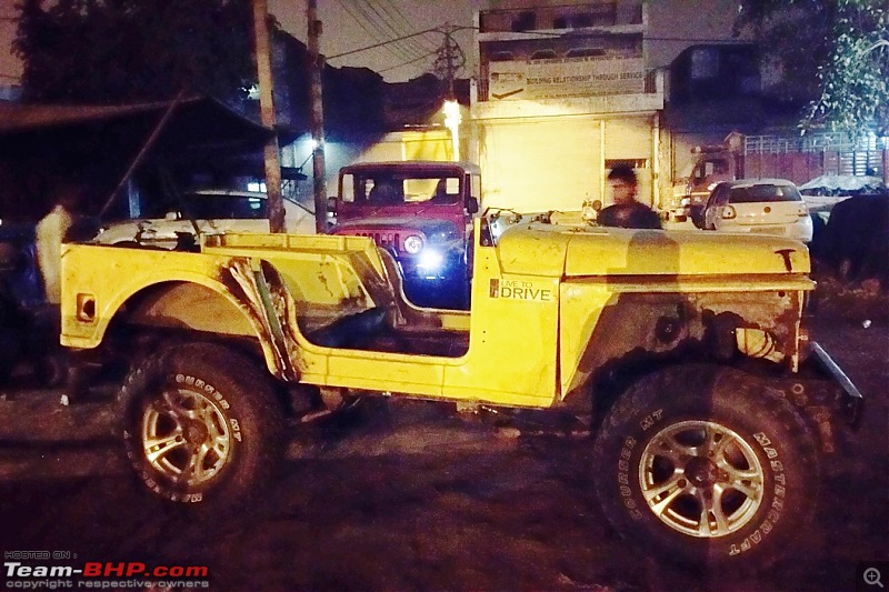

So, a couple of upgrades have happened in the last 2 odd months. Will detail them in a subsequent post but here's what the Jeep looked like last week.
In a parallel development I upgraded to the new Note 4, which I put to good use over the weekend ..
And on the day India beat Pakistan in the cricket world cup, I had one additional reason to smile ..
