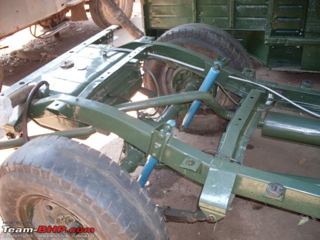

hi all,
there has been significant progress in the vehicle rebuild. the work is coming along nicely.
Work done so far are since last update:
1. The entire chassis has been repainted.
2. New shocks installed.
3. All brakes serviced and fixed.
4. Engine overhauled and placed, but not yet started
5. Diesel tank fixed.
6. All transmissions checked and fixed
7. Gear box fixed. There was water in the gearbox!!!!
8. The underside of the tub has been rust proofed and painted.
in the next week, the tub will be mounted and the engine will be started, once the radiator is fixed.
i have had a smooth run so far, so i had to hit a snag. And i have. REGISTRATION!!!! i am having problems with registration, but i am getting it sorted out without any under table dealings. So its going to be a bit lengthy process.
Now pictures
FK
